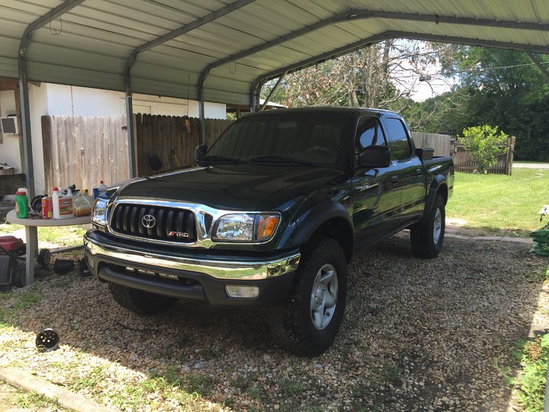

  13. Sep 11, 2016 at 8:47 PM
    Scoobarooo
    Scoobarooo [OP] Well-Known Member
    Jul 11, 2014
    #133735
    3,851
    Casey
    Brooksville, FL
    '02 DCSB TRD OR
    3" OME/Bilstein, Retrofits, Custom Bed rack/Toolbox, Amsoil Everything, tons of others.
    Yeah, that was me. Why would they look like twins? Aha.
    How she sits now

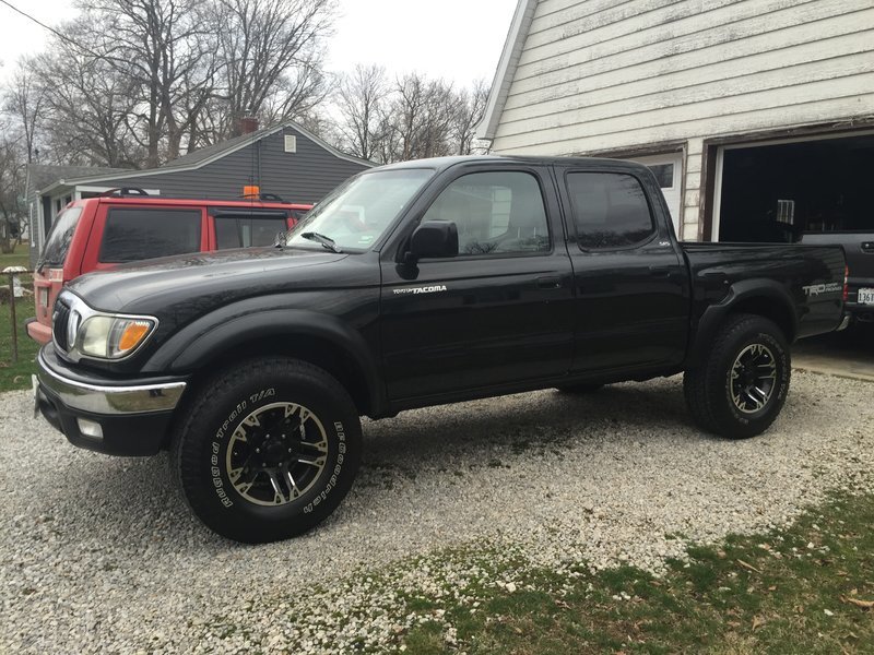

  14. Sep 11, 2016 at 8:53 PM
    carofchoice
    carofchoice Well-Known Member
    Dec 30, 2015
    #173539
    699
    Jeff
    Newton, IL
    2003 DC 4X4 TRD, 2012 X-Runner
    Also have a black double cab. this is the day I brought her home, can wait to change it up a bit.
    Have only added weathertech rain guards, husky liners, spray on bed liner, new double din stereo, tinted front windows, and dipped rear bumper, also did all maintenance items. I have been collecting parts since I bought it in Jan of this year. Getting the frame swapped next week and will start adding parts to it slowly.
