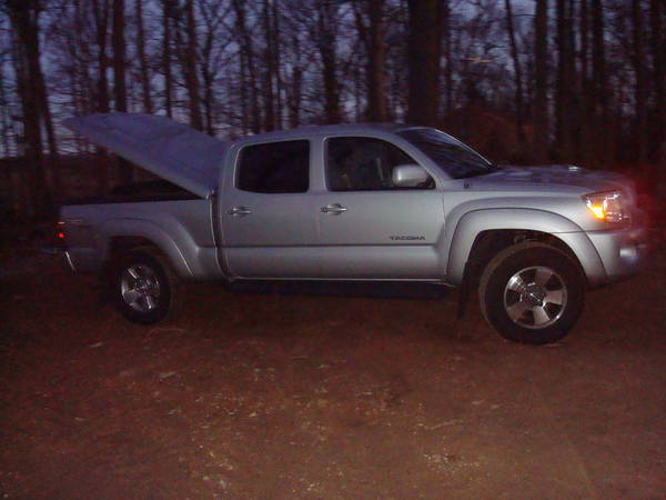

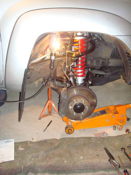

    Dawn of Lift Day...

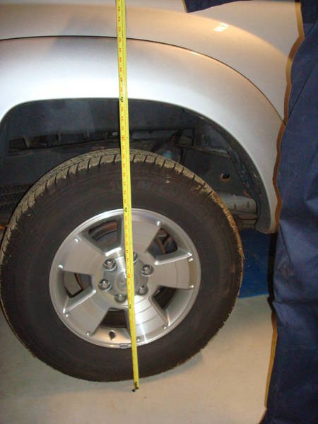

    Pre Lift Height about 35 " - Post is about 39 1/2" have 1/2 inch more in lift I could go.
    Front Install...Coilovers and UCA's
    Working on the Rear....AAL and new Bilsteins
    The Carolina Squat Look.....
    My Helpers....Ain't Family with Tools and Garages Great!!
    It's a little bit dark out...will post better pics later in the week....

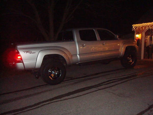

    TOYTEC Ultimate 3" with Coilover Bilsteins, UCA's, AAL's and New Bilsteins in the back, also Differential Drop Kit...

    Once we got the jacks in the right spots it wasn't but 30 minutes per side...use jack stands on the rear crossmember...you'll have to move the floor jack back and forth to get the pressure on and off to set the springs...we had to cut a slit for a screwdriver in the centering pin to back off the bolt also....
