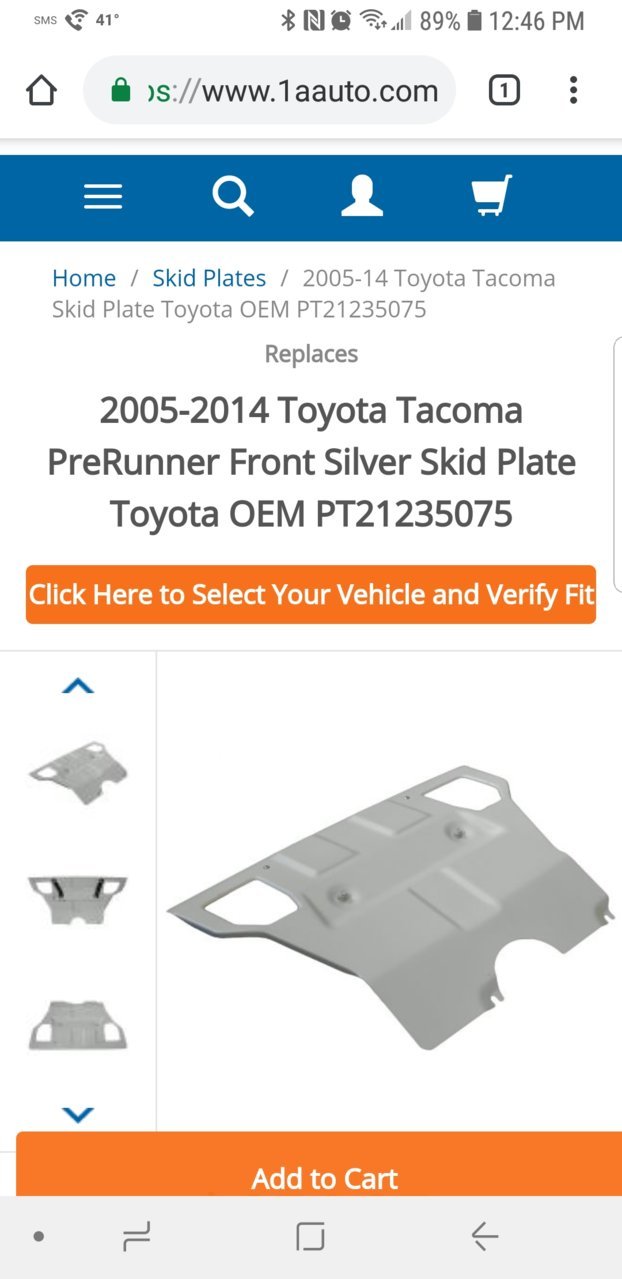

    Easier and cheaper to cut or trim your skid plate or try and locate this style skid plate which is stronger/more rigid.Screenshot_20190218-124651_Chrome.jpg

    Well what I was thinking about was bending it back into place and then going a step further this time and using a pair of pliers to curve the edge so that way it's not this sharp end facing the tire.
    I also was thinking of just buying a steel plate one and being done with it as well.

    I’d bend the OEM one back into shap again and try to figure out why it bent. Maybe bent it a bit further back than you did last time.

    No, the one I posted, doesn't, it is a stand alone skid plate, I had it on my tacoma before, bye its self.

    And it's aluminum not steel.

    Just go with a real skid plate for peace of mind.

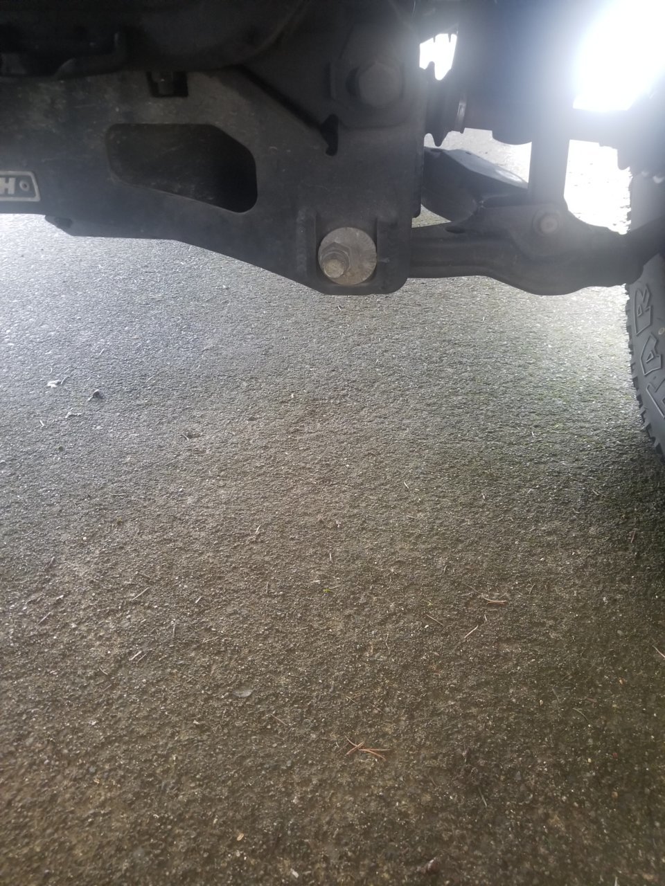

    The alignment cams rotate 360*.

    Yes they do, the location of them depends on the alignment of your truck, I've seen them in different orientations on different trucks.

    Looks to me like the tow and camber are reversed, you should have a little tow and its supposed to be aligned so if you let go of the steering wheel the vehicle will slightly favor the shoulder of the road.

    Correct. Yours are not wrong if your alignment is in spec.
    Lots of people rotate the front towards the center of he truck as far as possible and the rears out as far as possibly to achieve the most amount of clearance between the rear of the tire and the fender. Maybe that’s what he’s referring to?

    Yes that could be, the only thing I'm unclear on is how much caster should you have, positive or negative?

    Positive caster. Negative camber.
