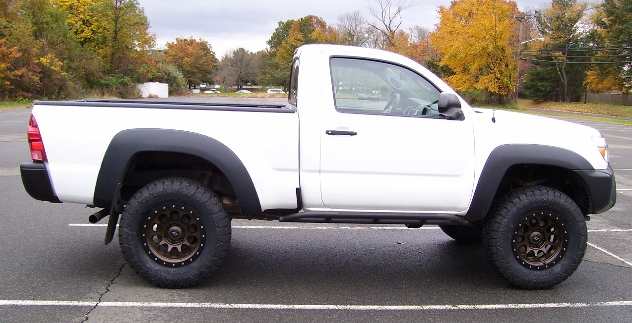

    The 885's shouldn't be a problem, I have them with then nitro shocks and SPC UCA's and with the stock sway bar on drop brackets with 16x8 wheels 0 offset and 285/75/16's it did not rub or contact anything. I have 17x8.5 -10 offset now with 305/65/17 tires and I get a little rub on the body mount so I plan on adjusting the UCA's to push the tire forward more. Do you have any pictures showing your truck as it sits, it sounds like the UCA's are too much.

    My shocks don't seem to top out, but one of the shocks is bad and I need to replace it in the spring. My truck has add-a-leafs in the rear with the 885/nitros up front and it sits pretty good.
    I wonder if your shocks are set too high.
