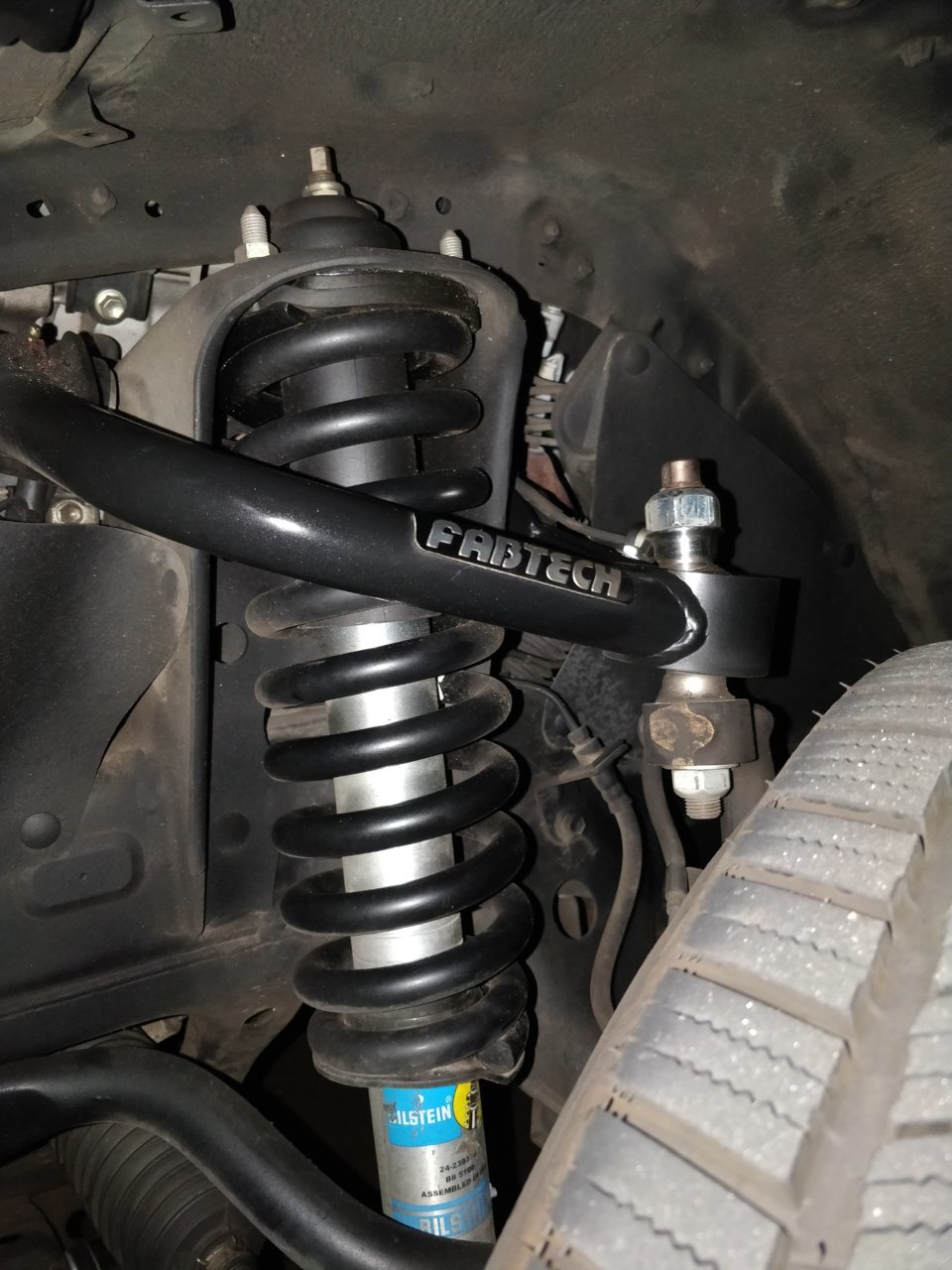

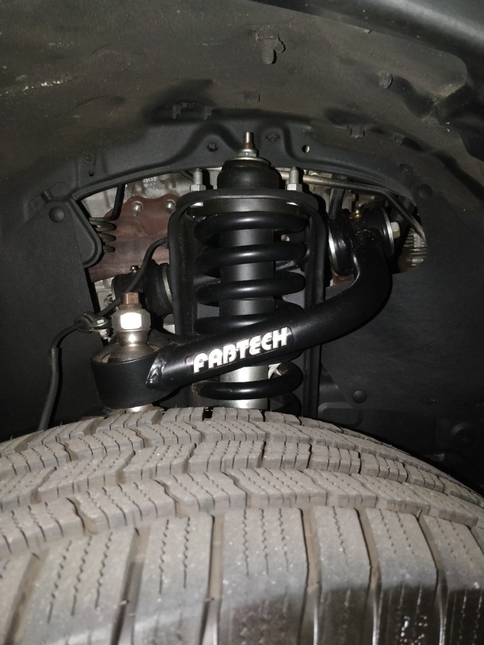

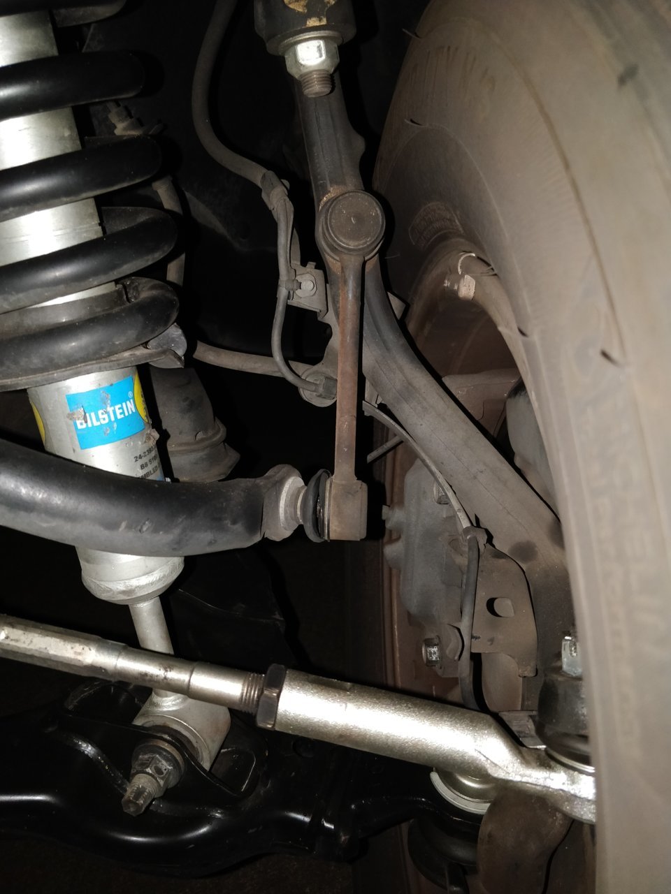

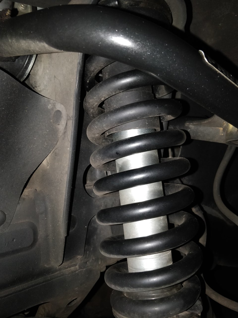

    Okay this is the best I can do until I get home into the garage, which will be about an hour.
    geekhouse23 likes this.

    Also, shocks are on zero from what I can see.

    Alright so I am home now, what do you all need to see if I need to take more photographs?

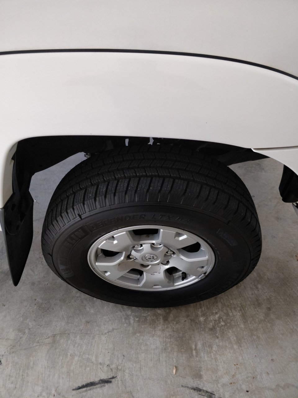

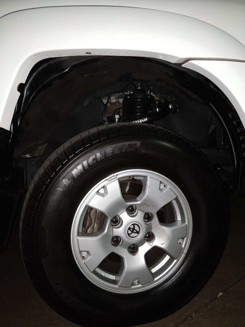

    Okay so the left from hubcap to fender is 22.75"
    And the right is 23.25"

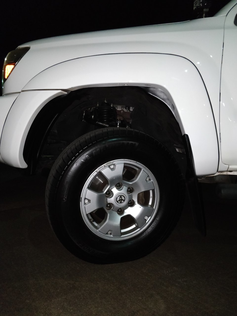

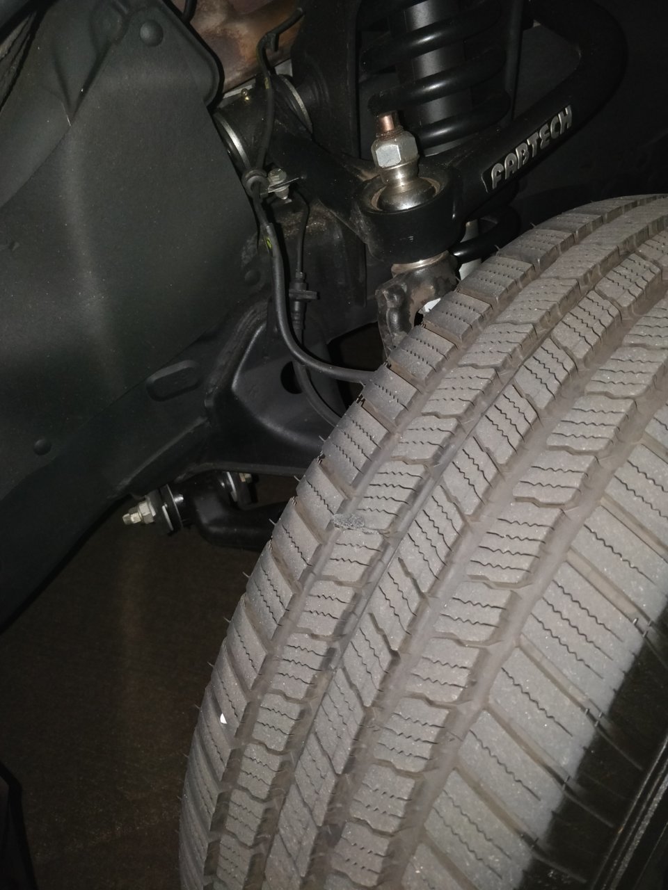

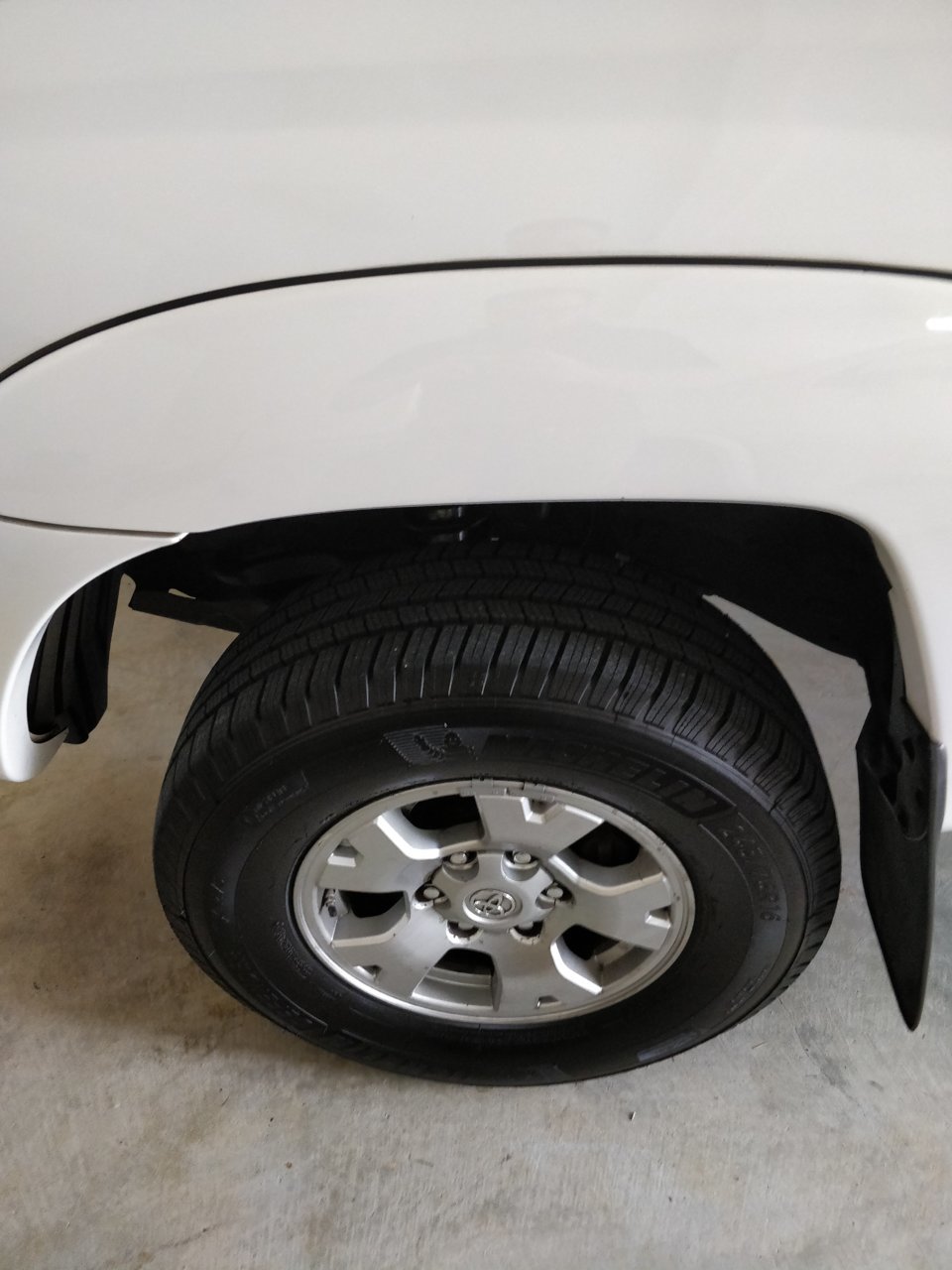

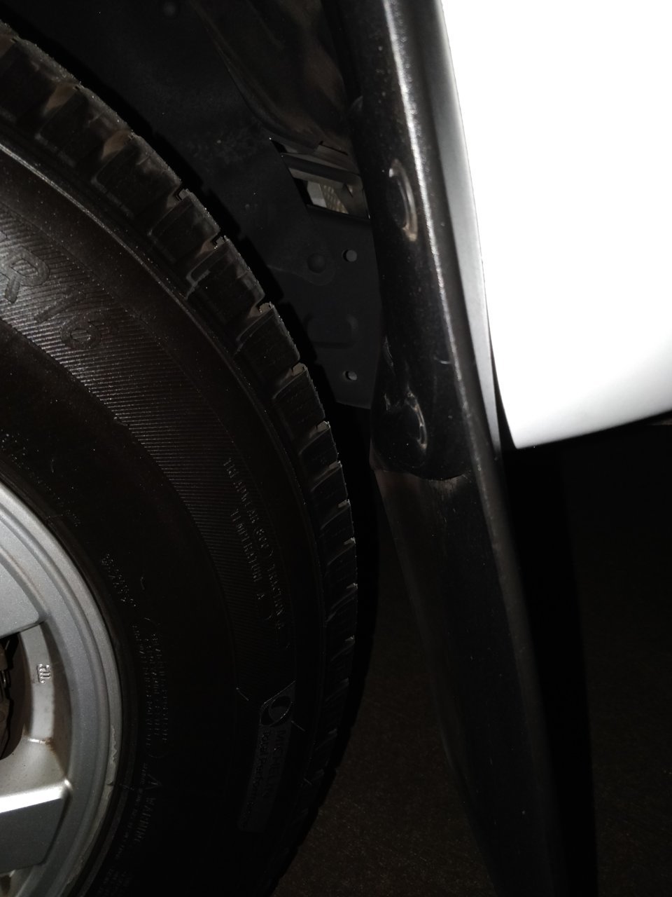

    Also I took some better photos so you can see how far back in the well the tires are

    It's actually both sometimes, the inner part of the wheel/rim grinds across the sway bar. The tire hits the skid plate.

    The height sounds about right for those springs, I'm actually around 23.5" on both sides. Is your wheel hitting the swaybar or is it the wheel weights, they seem to be sticking out pretty far. If it's the weights, you can get them removed and have stick on weights done if there is enough room to clear the calipers. But it sounds like those wheels are just tucked in too far and you probably need spacers to run them. Your lift combination might be fine the way it is. You might need a 1/4" spacer on the driver's side to level it out though.

    While that makes sense, it just seems crazy that he would need to run a wheel spacer. I have a similar height lift with 285s on stock wheels and don't rub. Granted I don't have a swaybar, but my tires don't rub the skid plate thats for sure.
    I don't recall ever hearing of someone's stock tires and wheels rubbing on the swaybar but I certainly could be wrong.
    Also, I don't see any damage on the wheels or swaybar @jross20 . Could you get some pics of the damage and of the wheel and tire actually contacting the swaybar and skid plate? Otherwise just looking at the pictures you posted, I don't see anything installed incorrectly or even anything coming close to rubbing. :notsure:

    @jross20if the wheels are too far back in the wheel wheels that means your caster adjustment is off. Can you post a picture of the current alignment specs?
