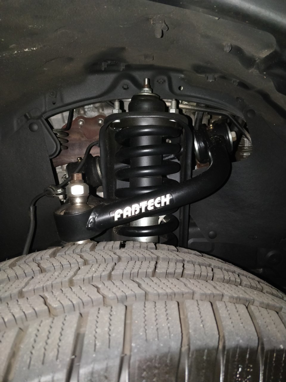

    Is the plate that the coil sits on top of in the right orientation? If its upside down, youll get a lot more lift than you bargained for.

    Post pics of what you have. Most here will see it right away if its upside down.

    Does this work?

    The spring perch is on the bottom of the shock, my bad.

    It's correct.

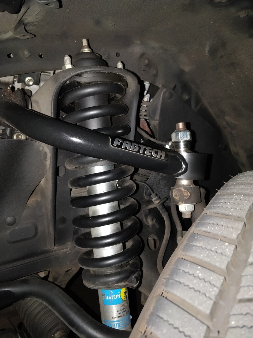

    Just a thought here as I am no where near familiar with the fab tech uca.... but is it possible they put the ucas on the wrong sides???
    That ball joint/spindle just looks to far forward to me.
    Harry likes this.

    I think he hit the nail on the head.

    Its impossible to install Fabtech Tacoma specific uca's wrong, but I have seen some Silverado arms installed incorrectly lol.

    No problem! The last picture posted with the control arms shows the uniball going towards the rear of the truck, not the front.

    Ah.. ok.. I didn't look very close.

    Wait, does this photo help?
