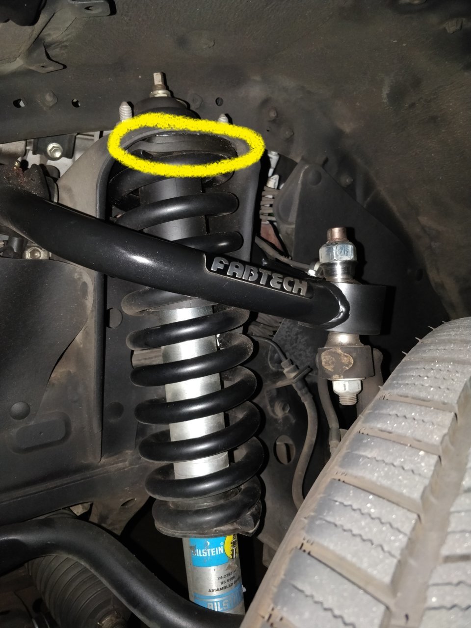

    JL8Jeff
    JL8Jeff Well-Known Member
    Feb 6, 2018
    #243662
    984
    Jeff
    Ewing, NJ
    2013 Tacoma reg cab
    OME 885/nitros, SPC UCA, 305/65/17, AAL
    What is the part number on your Bilstein shocks? I can see the 24-2393 but I can't make out the rest of it. What makes you think they are topping out, do you get a big clunk or something?
    The cushion at the top of your spring looks either misaligned or doubled up. The spring end on my shock are rotated inward so I can't see what mine look like. Check both sides and make sure they didn't put both cushions on the driver's side and none on the passenger side. If so, that could cause the lean and the clunk possibly.
    jross20[OP] likes this.

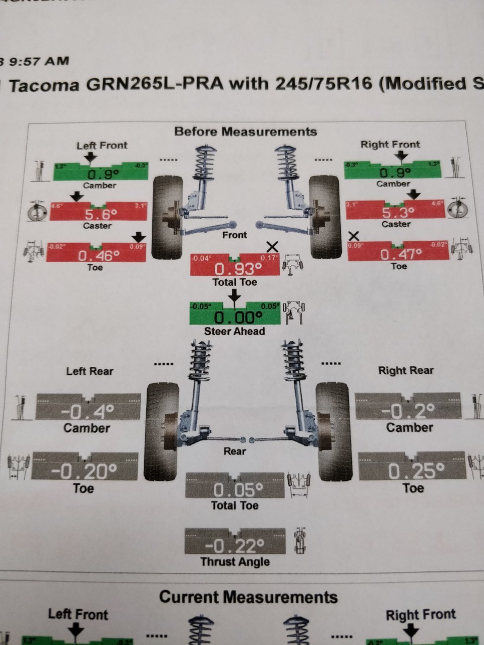

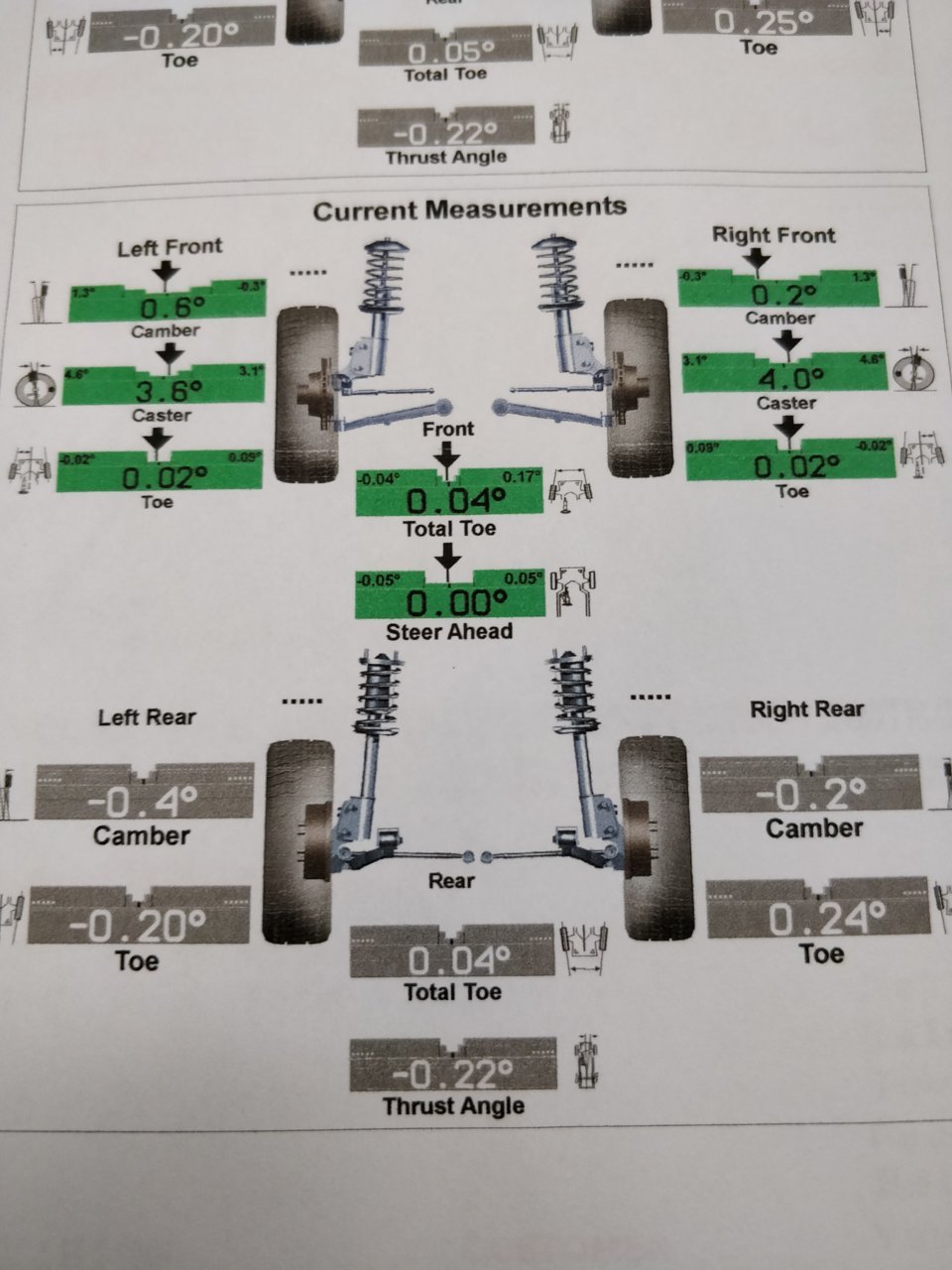

    jross20
    jross20 [OP] Well-Known Member
    Feb 19, 2018
    #244913
    2,028
    John
    Georgia
    2000 4Runner SR5 4x4 | V6 | Auto
    Tundra 5100s F+R, OME 880s+890s, duro bumps, etc
    Alignment results
  9. Feb 5, 2019 at 7:31 PM
    #89
    tcjacado
    tcjacado Well-Known Member
    Aug 29, 2016
    #195947
    41,570
    That looks ok.... you may need to look into limit straps for the front. Or extended travel shocks. Also would be advisable to get new bump stops in the front.

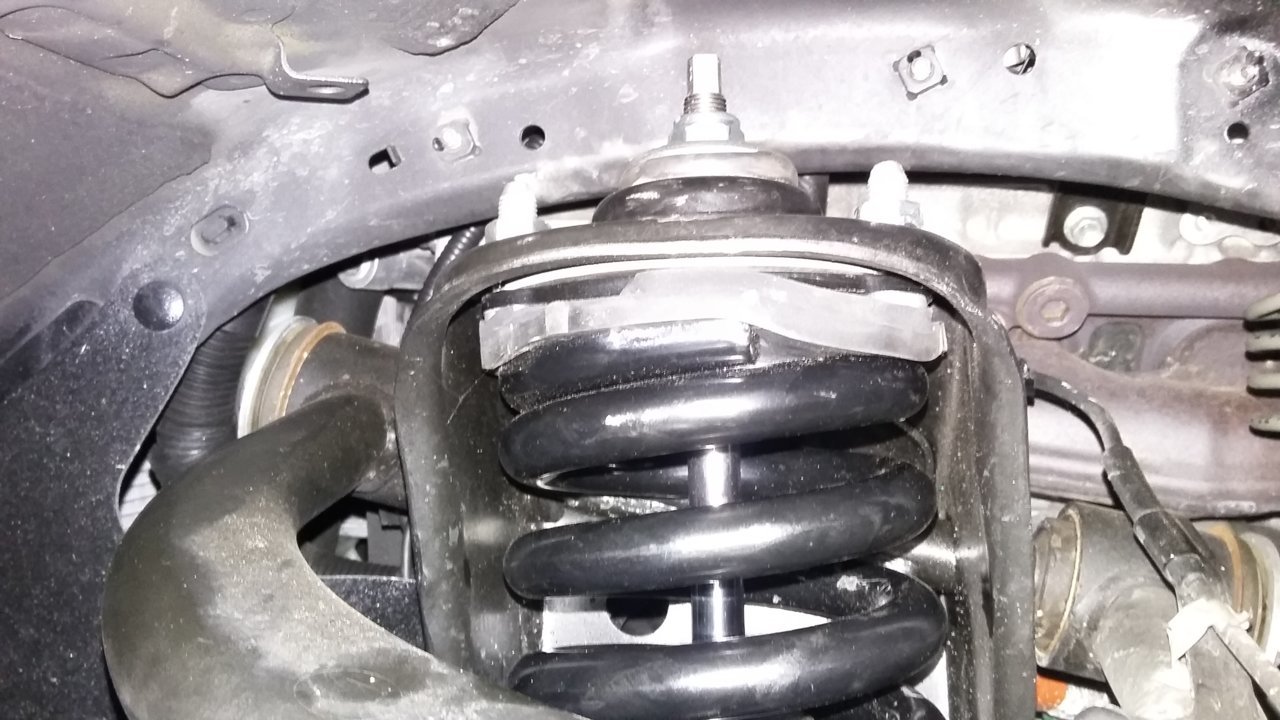

    jmanscotch
    jmanscotch Well-Known Member
    Jul 12, 2016
    #191851
    874
    Jake
    Colorado Springs
    2021 TRD OR DCLB
    It does look off, is the pad between the coil spring and mount upside down? If memory serves me well, when I installed mine, the smaller diameter portion of the cushion seated down inside the coil spring and the larger diameter portion was up against the top mount.
  19. Feb 6, 2019 at 6:45 AM
    #99
    MAG GRY TACO15
    MAG GRY TACO15 Well-Known Member
    Sep 5, 2018
    #265273
    5,068
    Alan
    GA
    '15 TRD Off-Road
    Same crap everyone else got
    The pic in this link, the side facing us in the pic is the side that faces up. You can tell by the 3 notches for the 3 bolt heads.
    https://www.summitracing.com/parts/kyb-sm5640
    Even if his was upside down, it would not be the cause of all his issues. I've seen that rubber part look wonky like that if it's turned enough and the bolt head indentations are aligned with the with the head even when it's installed in the right directions. If you looked at the opposite side of that pic where the tail of the spring isn't, it would look much more normal I bet.
    This is a pic of mine. Yes it is installed in the right direction but when I was assembling it I brain farted and didn't align the the bolt holes with the indentations before I screwed down the top hat and took the pressure off the spring. I didn't realize it til I was all finished with my install. I'll fix it one day but you can see it looks like OP's and yes I can say it's is installed in the right direction just clocked an inch off. Only down side I can see it premature wear of it b/c the top hat's 3 bolt heads are not in the indented slots and may tear the rubber during movement. I'll fix it one day when I have some time. But after 4k miles so far it looks the same as the day I put it on.
    jmanscotch likes this.
