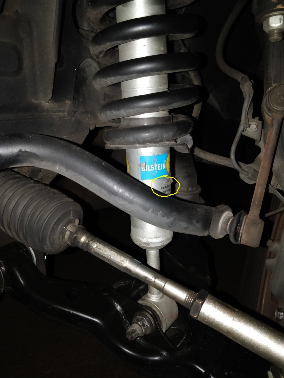

    The Bilstein part number is on the sticker on the shock. It seems odd that the wheel can contact the sway bar and the tire can hit the skid plate with stock wheels. Are those the original wheels to the truck? Can you get a picture showing the wheel hitting the sway bar and tire contacting the skid plate. Spacers still might be the least expensive fix for the time being until you can find the wheels/tires you want later on.

    OP, have you pulled that sway bar off yet? Start simple. The Tacoma World way is to throw money at problems. I believe the excessive caster from your UCAs is the root of your problems. Take it one step at a time. Pull that sway bar off and drive it for a couple days. Observe what changes. Your wheels and tires certainly won't be hitting the sway bar anymore. You may find that the bang isn't the shocks topping out. It may be the sway bar, maybe not though. There's only one way to find out - and it doesn't cost anything.

    I have 885s on 5100s, I didn't relocate my sway bar and I don't have any of the issues your having, I was on stock o/r wheels for a couple weeks also and never rubbed on anything, maybe its the swaybar relocate kit fucking everything up
