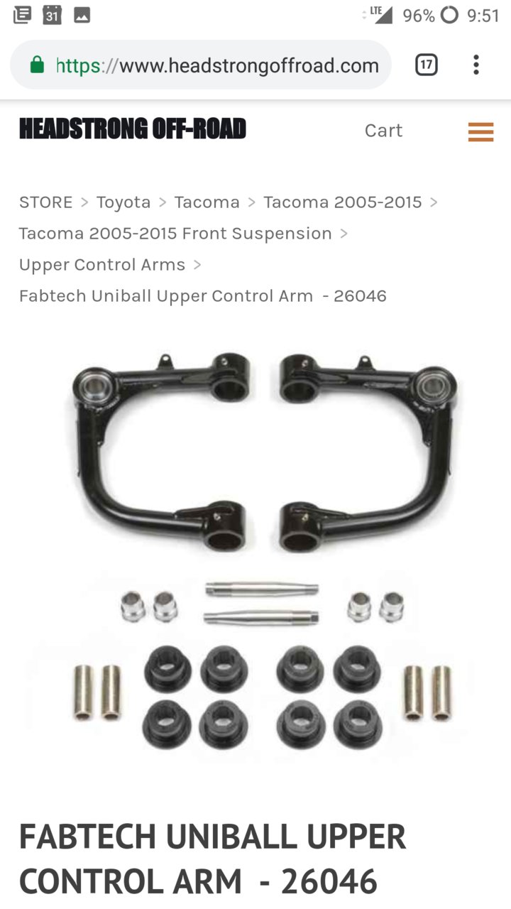

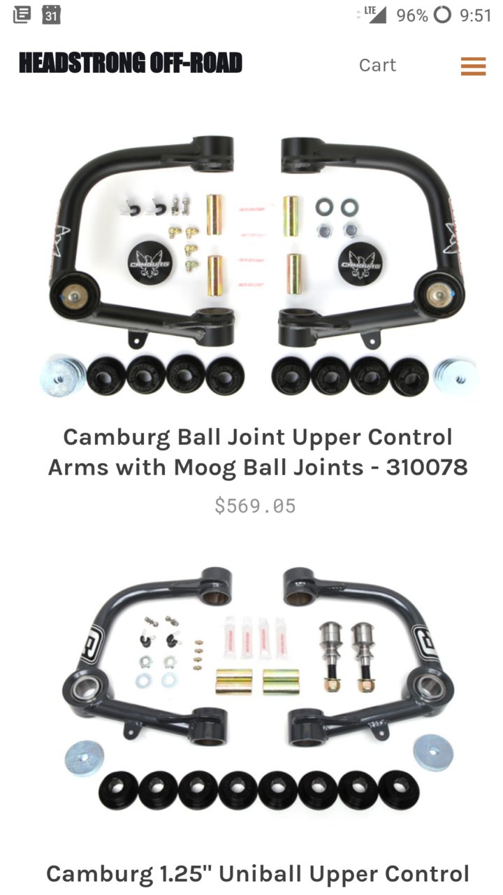

    Yes I am going to remove the sway bar brackets and try driving without it.
    But last night I did a little investigation, it's not exactly scientific but I think that the fabtech arms add way more caster than every other arm.
    So I got a bunch of different pictures of like the stock uca'a, camburgs, total chaos, fabtach, etc. pretty much all of the sites had a top-down vertical photograph of them. the fabtech is the only arm in which the joint is basically lined up with the bushing joint. I was going to make a little diagram but I didn't have time last night...
    Basically it looks like the fabtech arm is as far back as possible while maintaining a u shape whereas all of the other arms are nowhere near this far back, that leads me to believe that this arm adds the most caster which explains why they've had to adjust my wheels so far back into the well because the caster is so high.
    There was someone a lot earlier in the thread that mentioned that he believed the fabtech arms were really only good for 3 to 6 in of lift, at this point I believe that he is spot-on.
    I also got under the truck for a minute this morning to look at how the lower arms are adjusted, and it does look like they're tilted back as far as possible.
    Okay so I got some screenshots from headstrong website, it's not as fancy as what I was going to try to make but I think it shows off what I'm talking about. The fabtech arm's are the furthest back, which would indicate that they would give the most caster.

    Do you plan on getting taller tires in the future? If so, those fabtech arms might cause the taller tires to hit the cab mount. If you don't plan on going to taller tires, then just go with the spacers until you can afford/find the wheels you really want. If you're just trying to make the truck driveable for now without spending much, the cheapest route is to remove the sway bar/drop bracket, bend up the edges on the skid plate (or remove it) so it doesn't contact the tire or do the spacers to get the clearance. New springs, UCA's, shocks are all going to cost a lot more and might not even solve your issue.
    The SPC UCA's should be fine for your truck if you need new arms since you don't go offroading. They have quite a bit of adjustment. Don't read too much into guys breaking them, a lot of guys abuse stuff and don't admit it.

    1. That’s a ton of caster compared to stock. Is all the caster achieved at the upper ball joint vs the lower control arm? We’re the alignment cams touched when it was aligned?
    If you leave the cams in a “neutral” position and align it with that much caster the wheels get pushed too far back in the wheel wells. This will cause them to rub the mud flaps and inner fender.
    2. Have we determined if the sway bar relocation brackets are installed correctly? If they’re backwards, it would pull the sway bar closer to the suspension.
