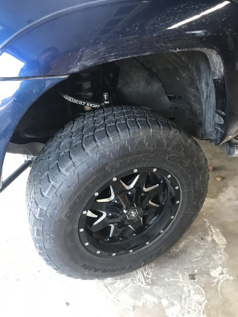

    Jasper Al
    Indigo Ink Sport DCLB/White RC I4 5MT
    BLACK AND BLUE STUFF
    I put some built right uca arms on mine with a uniball their like 469$ i bought mine used but they helped align my truck and ride better theres a thread on them.

    decide if you want ball joint or uni ball. Uni ball is much higher maintenance, especially if you live in a salty/ wet/ or wintery environment. Ball joints are very low maintenance and easy to replace (on SPC and JBA atleast). I believe Camburg add 2 degrees of caster. With my UCAs set at 2 degrees, the alignment guy was only able to squeak another .5 degrees with my 3 inch lift.

    6" Fabtech with BDS/Fox rollovers and shocks, stretched YAKIMA load warrior rack, custom hybrid winch bumper, Rigid lights, onboard air.
    Now a 3rd option, delta joint by Icon dynamics, and you c as n put them in total chaos and other uca's, like a ball joint with more articulation.

    Delta joints last longer than uniballs and are grease able, best of both worlds.
