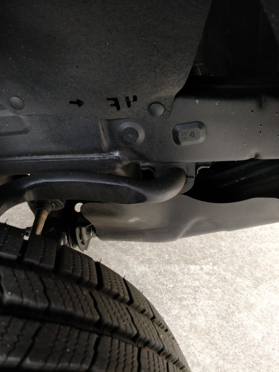

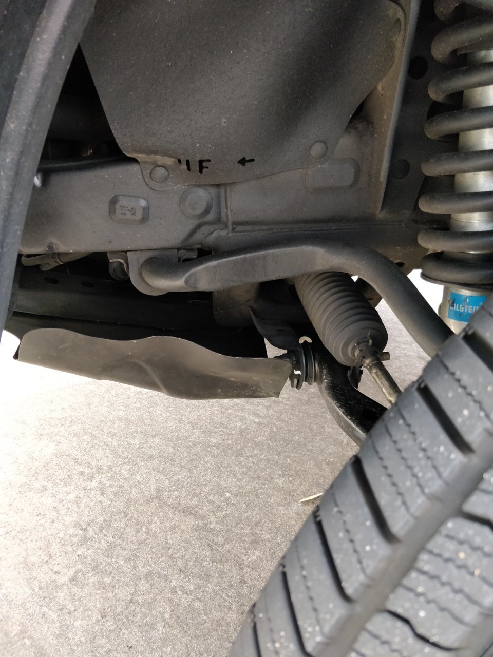

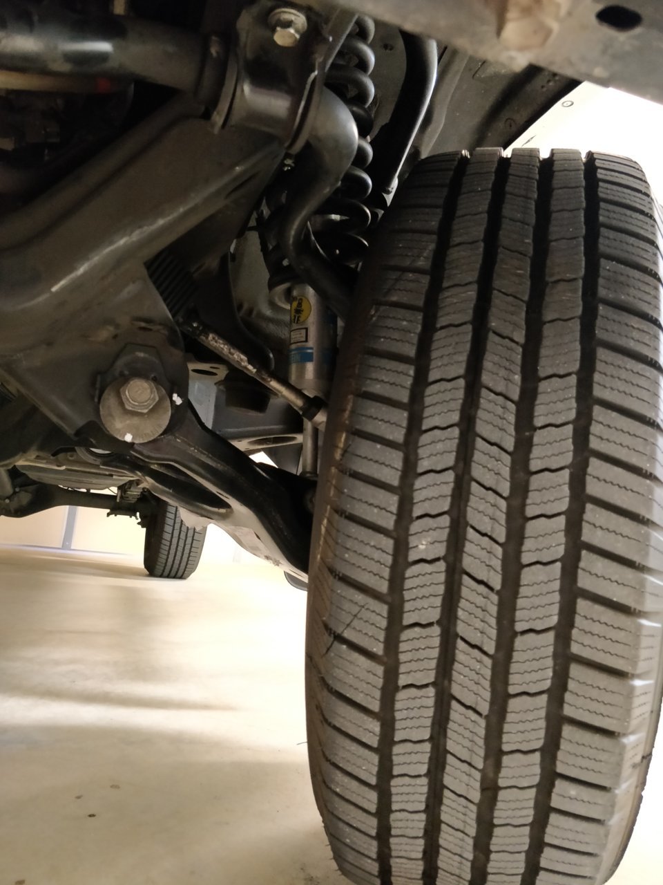

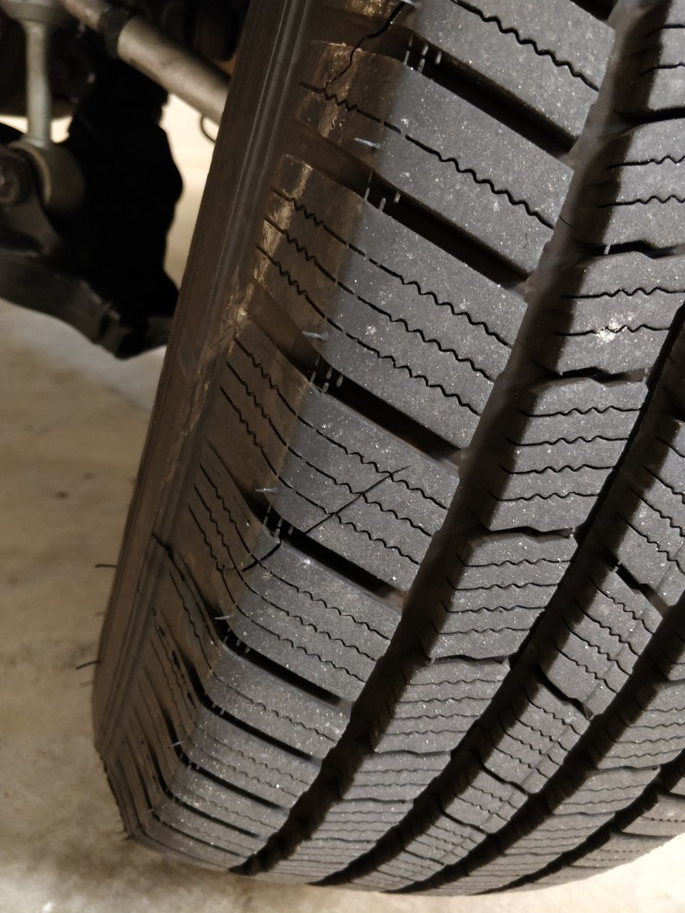

    It looks like removing the relocation bracket has moved the sway bar enough that it misses the wheel and rim!!!

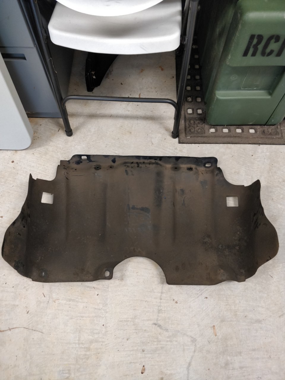

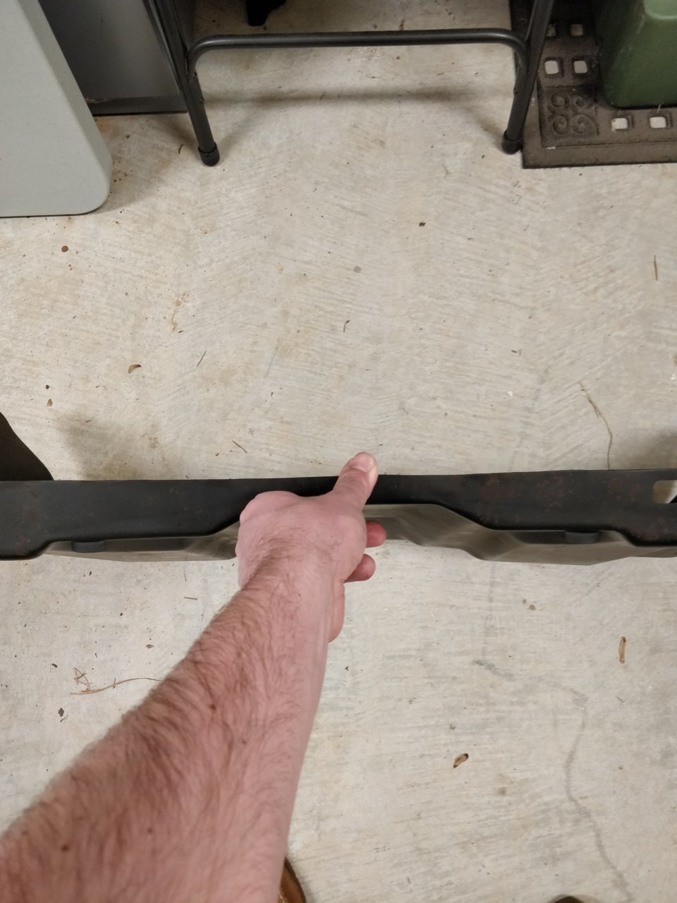

    After I fixed that I turned my attention to the splash plate or whatever the hell we call it. Good Lord it was bent all kind of ways, it may not come across in the photos but this thing definitely has seen better days.
    I took it outside and manhandled it all over the pavement, took out all my frustration, I put it back and now it's nowhere near the tires even at full lock turn.
    Yessss!!!
    I just took a shower because I was fucking disgusting, and now I'm about to go test drive.
    Below I have some pictures of the plate before and after and also the damage that I presume it caused to my tire that cut is one of two.
    JDB 2010 likes this.

    Hope this solves it
    jross20[OP] likes this.

    So far it did!
    Yes she seems to be able to turn lock to lock now without exploding.

    Yeah even my mechanic was surprised, one of his guys has a 4x4 2nd gen who had a bad time with them.
    So far seems to be just fine, it feels like it's easier to steer but I don't know if that's a placebo or not... The only lock-to-lock turning I've done I did very very slowly since I was a bit worried... Haha.

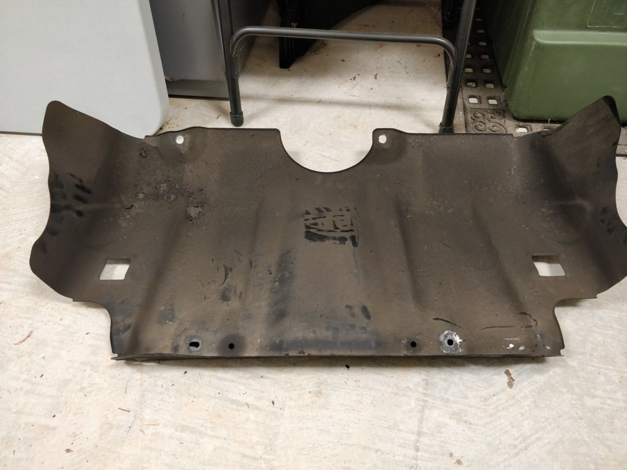

    Okay so the splash plate "magically" bent back out again. I seriously don't know how. The tire almost contacts it now but that means the tire didn't bend it...
    Pictures showing the different from left to right

    Weird.
    I’ve bashed mine off of stuff and it’s not that bent.

    But the thing is it keeps becoming this bent and I can't figure out how or why

    Take an angle grinder and cut that portion of the bash plate off on a sweeping angle.
    I think the plate is flexing for some reason and it ends up stressing that area which then flexes and bends outwards. The design of the plate and angle means it is much easier to flex out then inwards.
    What I would look for is any frame cracks that is the contributing factor.
