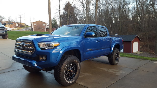

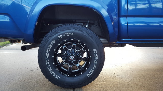

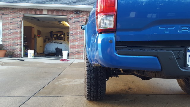

    My son and I put my Toytec boss on a week ago saturday. Got 2" front and 2" AAL rear. I went back and forth on wheels and tires. Finally decided on Ballistic wheels and 285/70/17 Cooper AT3/ I am happy with the outcome. I drove myself nuts with offset and backspacing choices. I ended up going 17x9 with zero offset (5" bs) I didnt want tires too far out past fender just flush. As you can see , it was right on. I was worried about tire rubbing UCA or cab mount. While I havn't and dont plan on off roading it. so far so good, no rubbing. The only place the tires did rub was on the air dam. I trimmed a little and was fine but then decided to take it off and I think I like it removed better.

    PVT Pablo

    Good call on the offset / size. I love that it doesn't stick out at all. It limits your rim choice but looks like it belongs on the truck.
