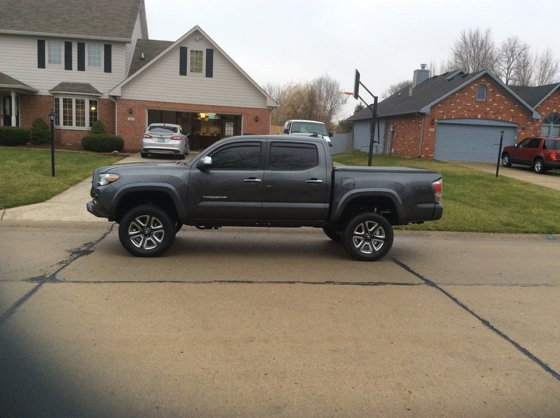

    OK, LIFTS COMPLETE, NOW WAITING ON WHEELS AND TIRES TO COME IN.
    I PUT ON 3RD GEN 5100'S WITH OME 888 COILS, LR UCAS, ICON 3LEAF AAL WITH 1" BLOCK.
    EXACTLY THE STANCE I WANTED!!!! THANKS TO MARIE AT HEADSTONG, SHE WAS AWESOME!! SHE PUT UP WITH ALL MY QUESTIONS.

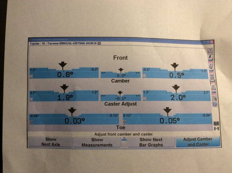

    Post up the alignment spec sheet if you can as well. Hopefully he didn't align to Toyota factory specs.

    Here's the alignment sheet

    Alot of trucks do not benefit from the cb drop.

    3° caster is attainable and desirable from you aftermarket UCAs.

    Exactly caster is to low, dealers are clueless to aftermarket alignment specs.
