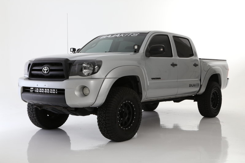

    How much are you looking to spend? How do you use your truck?
    We have our Chase Kit available! But a simple 5100's all the way around with an AAL might be perfect for you!
