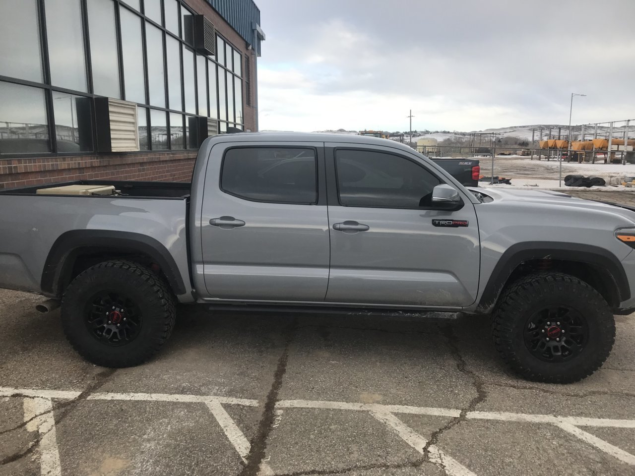

    Very minimal rub without a lift. Running the same tire without any modifications. 2018 Tacoma TRD Pro.
