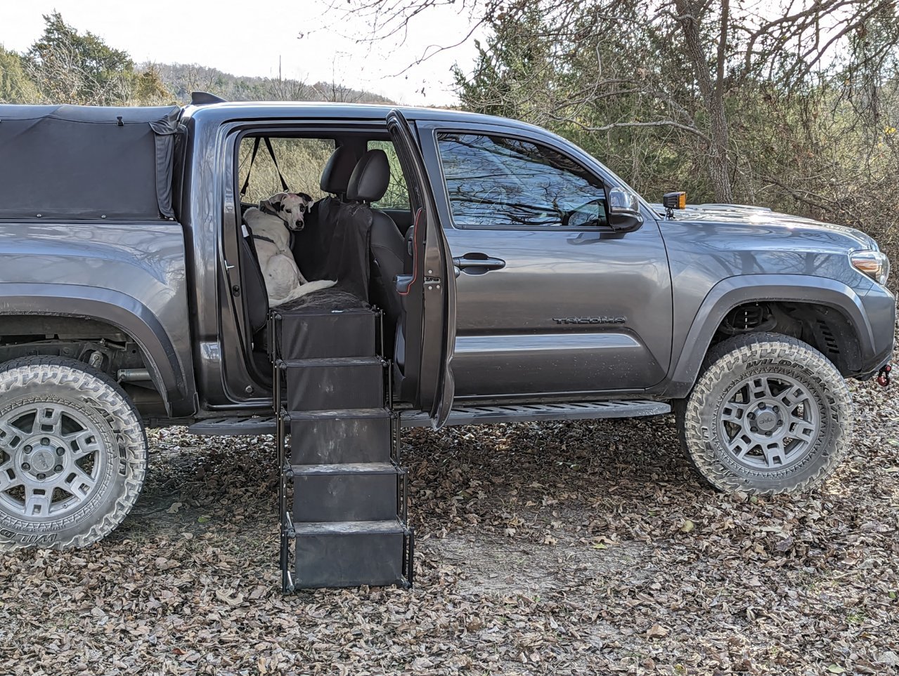

    Rock Lobster
    Rock Lobster Thread Derailer
    Dec 14, 2018
    #275833
    13,455
    Dee Eff Dub
    I drive a Miata.
    This happens to be a recent picture.
    6112/5160, clip position 3/4 out of 6.
    If you have the budget for 6112 (which is still on the cheap side for most "good" suspensions) I highly recommend it. It's a fantastic ride, as long as you set the clips to preserve some downtravel.
  7. Feb 19, 2023 at 3:32 PM
    #47
    Stuck in VT
    Stuck in VT Well-Known Member
    May 19, 2022
    #397569
    417
    Utah
    2019 SR SX MGM
    Nice stairs for your pup!
    Rock Lobster[QUOTED] likes this.

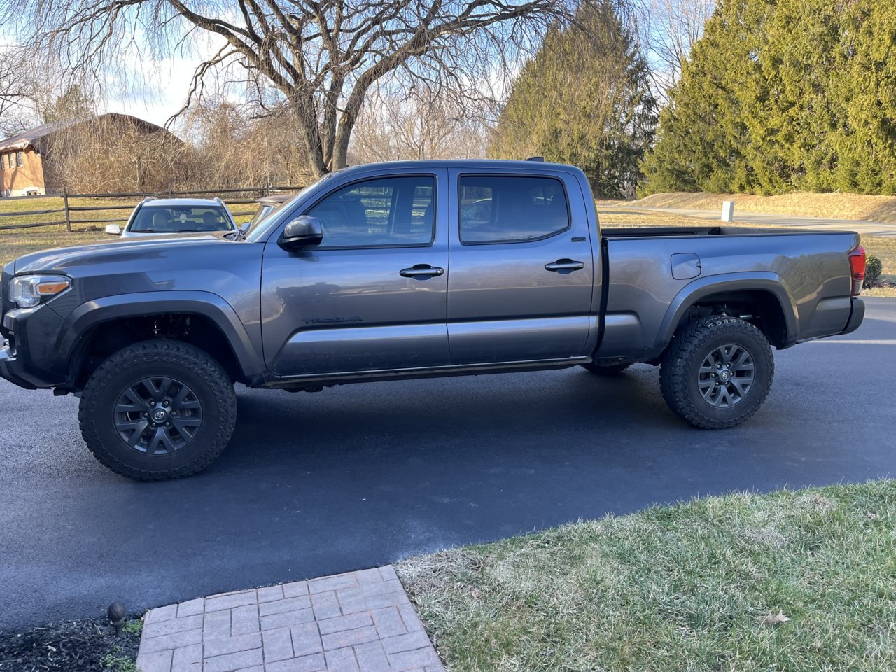

  8. Feb 19, 2023 at 3:34 PM
    #48
    Backdoc
    Backdoc Well-Known Member
    Jul 16, 2021
    #371405
    885
    Harford County, MD
    2021 SR5 DCLB
    Bilstein 6112/Eaton Truetrac/RCI sliders Some other stuff
    I installed a 6112/5160 kit today. I had spacers up front and I am glad I went with this set up. I drove it after the install and the ride quality is definitely noticeably better than the stock set up. Set at 10/8.
  9. Feb 19, 2023 at 3:39 PM
