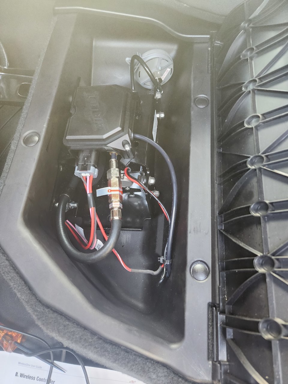

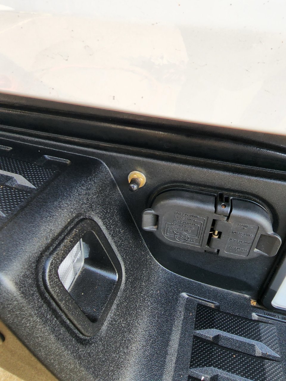

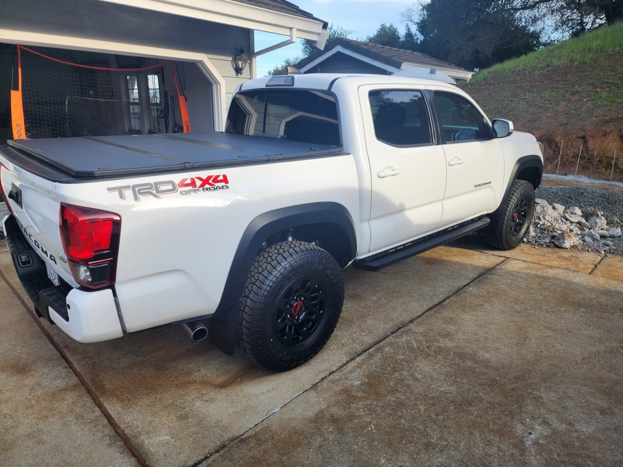

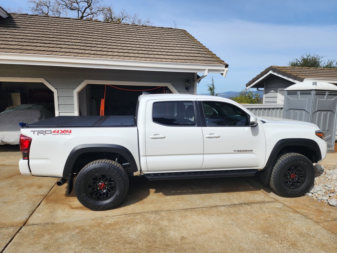

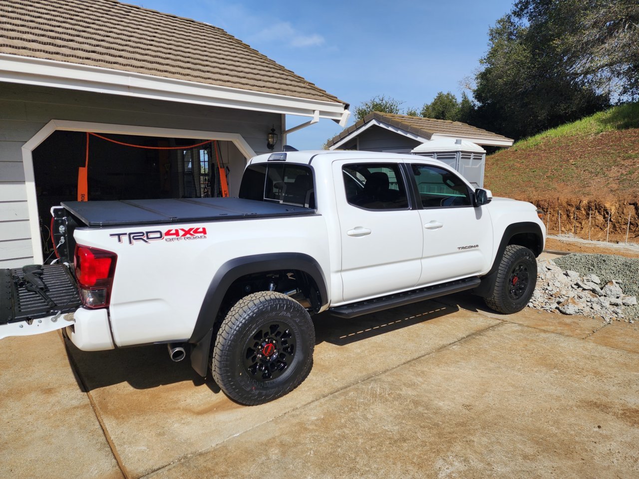

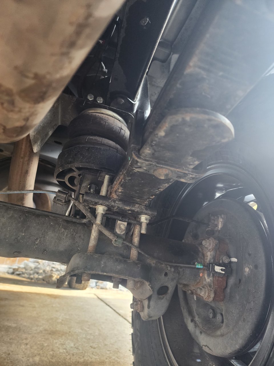

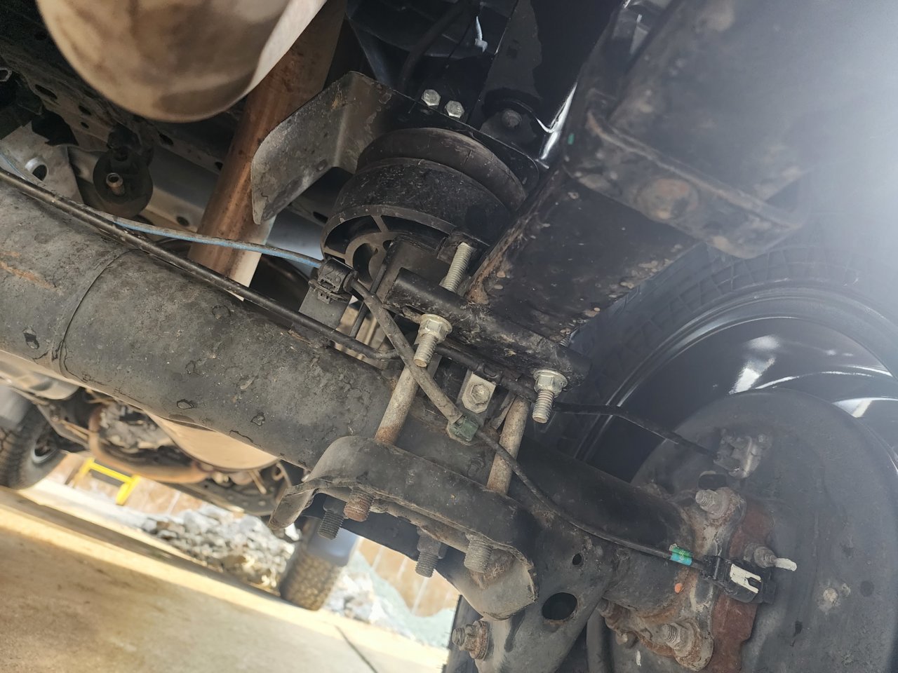

    With the bags, I typically keep 5 to 8lbs in them and it sits at 37" (from level ground up to the wheel well). I can air the rear up to over 39".
    20230220_082013.jpg 20230220_083307.jpg 20230220_083325.jpg 20230220_083337.jpg 20230220_082110.jpg 20230220_083420.jpg 20230220_115155.jpg
    The Air Lift system has 3 preset air settings. I have them set at 8, 20, and 40. I can air up and down from my phone or the remote in the console. I also have a valve on the back bumper to fill the bags manually.
    The last few images are with the bags 'all up'. I never drive like that, I was just showing how high they could go. I've hauled a full cubic yard of 4" river rock in the bed and these bags leveled the truck with 40lbs of air. I usually drive with it level (5-8 lbs of air)

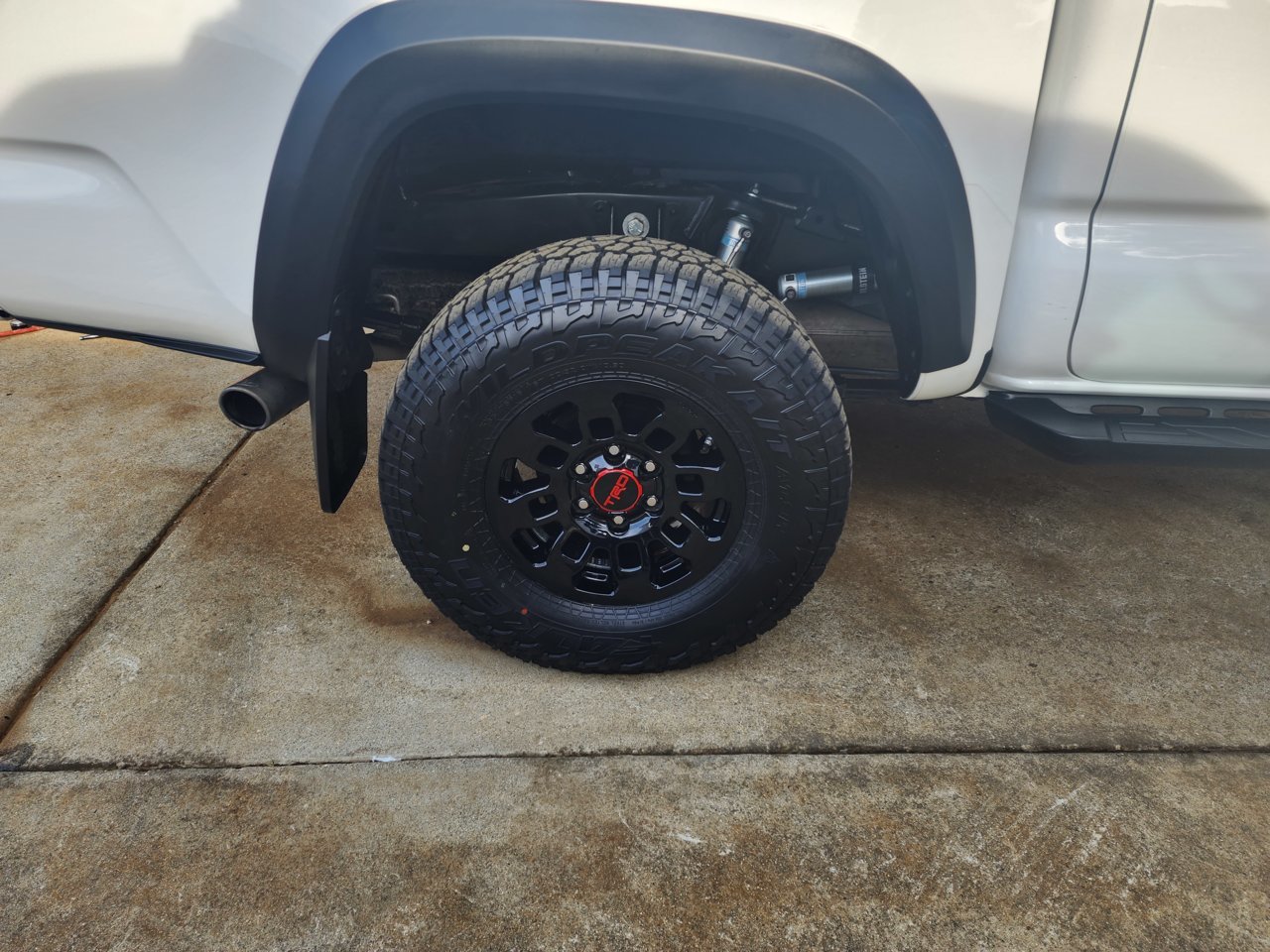

    Here is the truck with 8lbs in the bags:
    Hope this helps. Don't do spacers. You will end up having to align the truck after the spacers. May as well buy 5100s (because you will eventually) and align it once.
