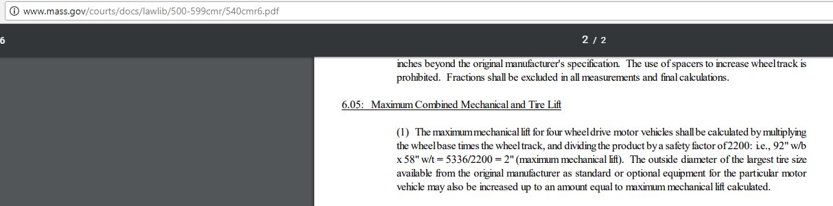

  19. Nov 14, 2017 at 7:59 AM
    #59
    foy1der
    foy1der Well-Known Member
    Sep 18, 2016
    #197597
    570
    W1FOY
    2017 OR DCLB
    Seriously, stop thinking that it's a 2" max. For your truck it's 3.6 inches. 63" wheel track x 127" wheelbase =8026/2200=3.64"
    ChadsPride likes this.
  20. Nov 14, 2017 at 8:43 AM
    #60
    Comb
    Comb Known Member
    Oct 27, 2016
    #200814
    1,834
    2017 TRD Sport 4x4 DCSB 6MT BBP ABCDEFG
    OVTune Verified Purchase
    And with the 285/70 R17s, he's using up 1.05" of that, leaving him with 2.59" for suspension lift. Seems doable to me.
