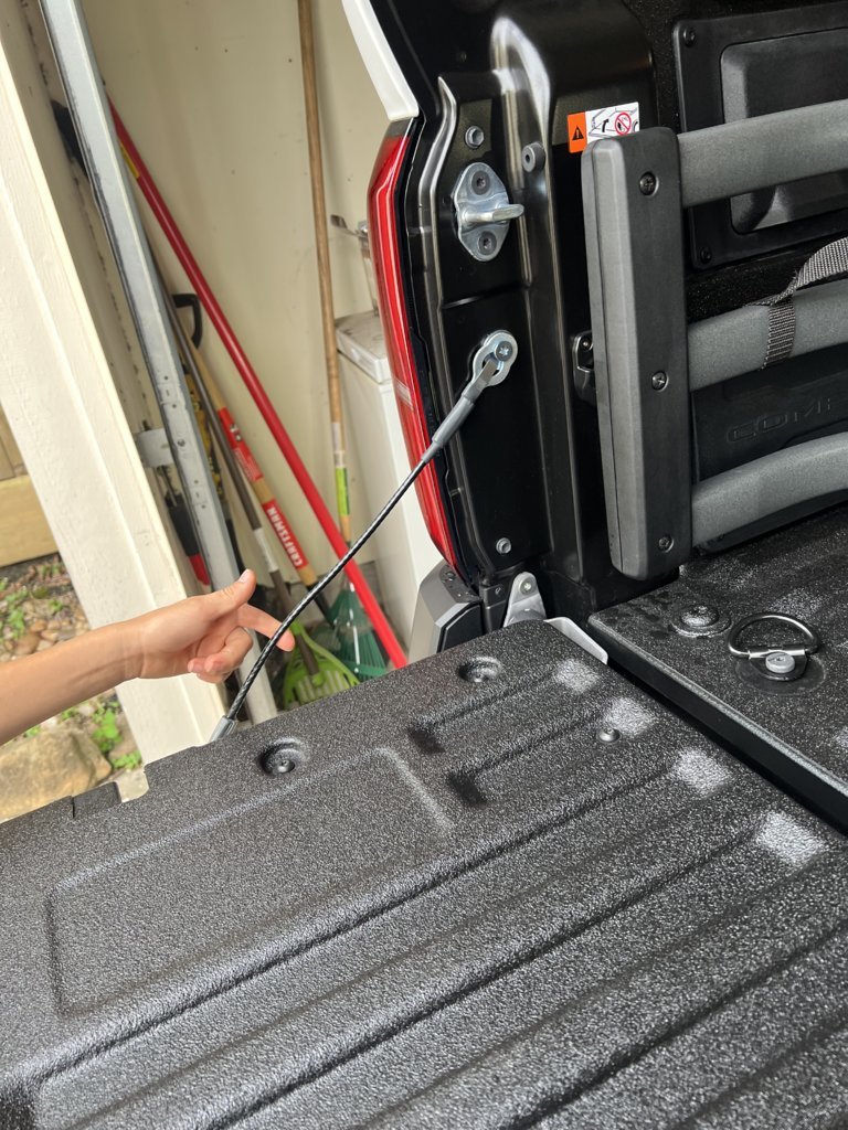

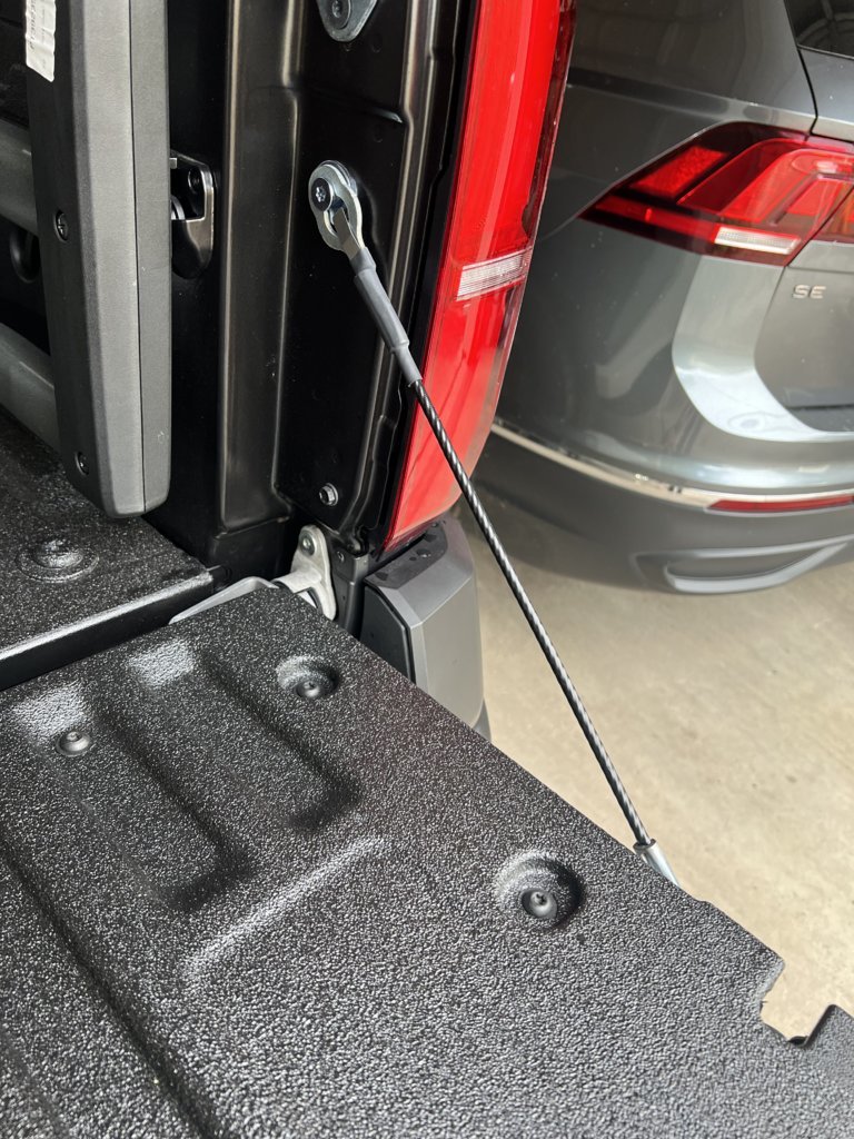

    The right support cable on my lift gate appears shorter, so it’s holding the whole weight of the tailgate (and anything I put onto it). You can see my son pulling on the loose left side. Is there any way to fix this?

    Mine is the kinda sorta the same way with the left seemingly loose. But when I jump on top of only the left side it pulls taut. Can you replicate?

    Try to switching the cables sides for shits and giggles. While removed, compare the length.

    I don’t have the tools to remove the bottom bolt / star screw thing. But I took off the clips. Both appear to be 16.5” long. So the bed must be warped or something but it looks fine visually. I took a ton of measurements and it’s all the same both sides. I just cannot explain it. The distances between the two points are about 1/8” off somehow.

    If the cables are the same length, the mount points on the tailgate or the bed might be off.

    I swapped the cables and it improved. I also noticed the bolt on the right side was driven awkwardly and that’s probably why it’s doing this. Now if I sit on the tailgate it actually tightens on the left side. But it’s loose with no weight. I guess I can live with that.
    At least it’s not a deflected tailgate or a twisted frame or something too weird. Just less than perfect finish.
