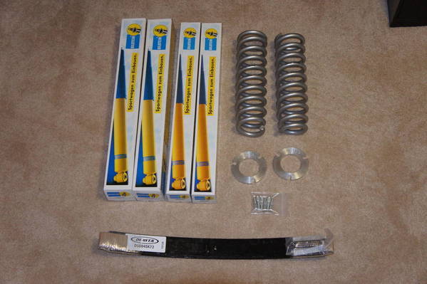

    After much debating - I now have everything for my planned lift. I am having a the local dealership do this install on Monday. Check out my setup and let me know if you have the answers to my questions below.
    Front
    * Eibach Coils (Toytec)
    * Front Bilstein 5100's adjustable shocks set at .85 (Downsouth)
    * Front Top Plate Spacer Kit 3/4" lift (Toytec)
    Rear
    * Rear TSB performed by dealership (Toyota)
    * Rear Bilstein 5100's (Downsouth)
    * Toytec Rear AAL w/ TSB Springs 1-1/2" lift (Toytec)
    Wheels
    * 18" Black KMC XD Monster Wheels (Firestone)
    * 275/70/R18 Nitto Terra Grappler Tires (Firestone)
    Questions I have:
    1.) Am I missing anything for the lift install on Monday?
    2.) I heard people discussing UCA's... Will I need them?
    3.) Any info or tips I should provide the dealer with when doing the install? I dont think they have ever installed this setup before.
    Much appreciated for your help and support! Now for the pictures!

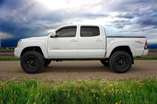

    Well I'm Lifted!!!
