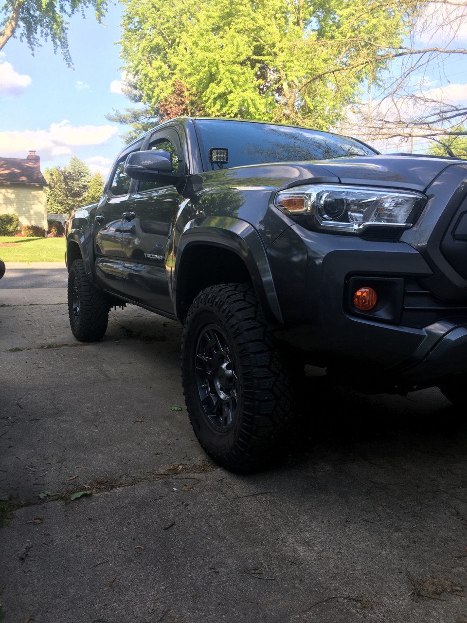

    Thanks all for responses. Lift done. Sits perfectly level. new rims (4runner pro rims in gloss gunmetal) match the MGM perfectly.
