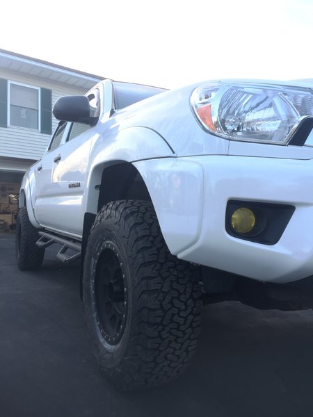

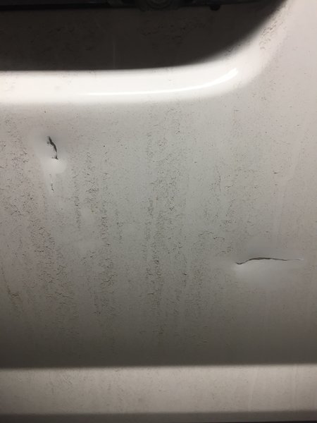

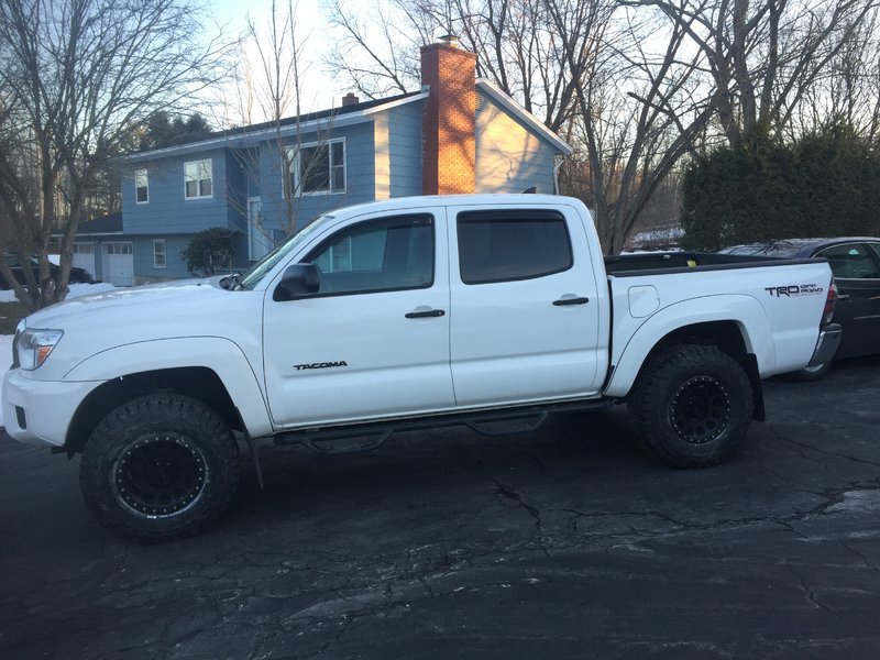

    Well it's took 7.5hrs.. the tears had to be cut out with a cutting wheel (air guns are awesome) had the Hi Lift in the hitch kick out 2 times while it was way up to get to get the leafs to open. Luckily we had jack stands and that my stepdad didn't have the truck crush him or his hands... tailgate has some gouges now.. The center pins that came with the kit are cheap and the 1st one stripped while turning it in not torquing so I had to get a grade 8 bolt similar and grind the head down to fit. The left strut tower had a seized and stripped bolt that took some time to get out and then assembling the tie rod the crown but was too striped and rotted to reuse so I had to buy a new tie rod end just for the nut ha.. but it's all done now and I love the way she sits!
