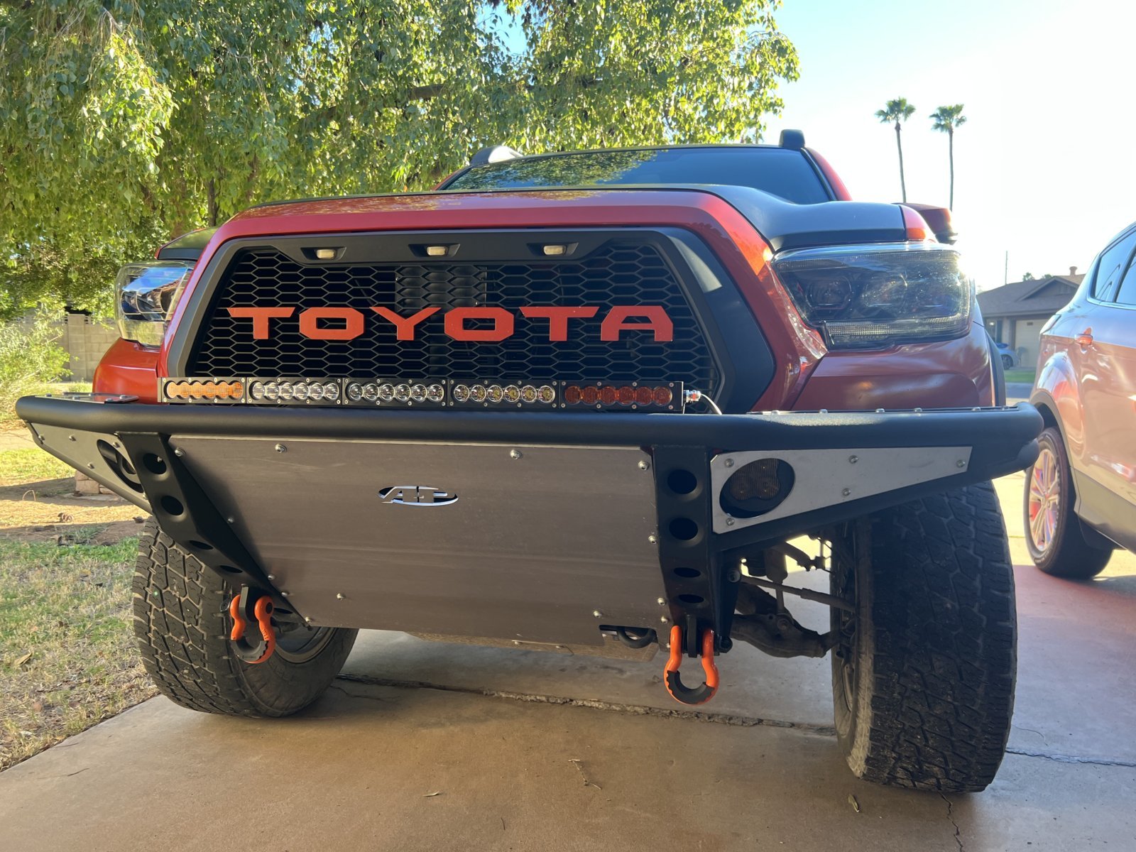

    I have a 3" lift, 285's, and an aftermarket grill that moved the sensor up about 3" with no re-calibration and everything still works as it should.
