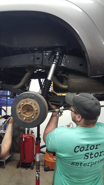

    One side just about done

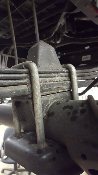

    Shims thin side towards the front or rear?

    For.....the rear leafs I suppose? Pretty sure its thin towards the front to clock the shaft up.

    Rear not going a easy as they thought

    Left overload in, and using a 3 degree shim and it looks like the axle has to twist for it to lay flat

    Go without shims.
    I never needed them.

    And yeah, that AAL pack is way more of a pain in the ass than a full leaf pack.

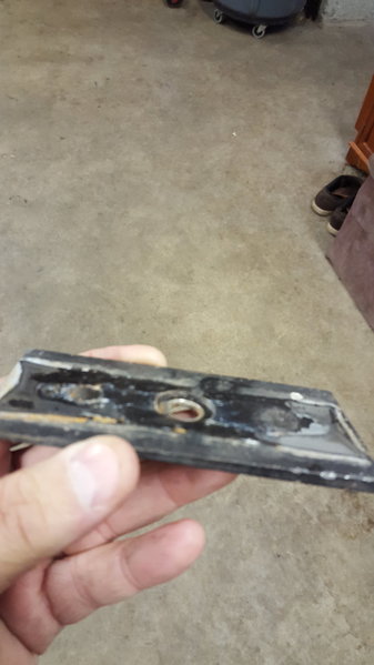

    Even the factory shim James don't use it

    Factory shim?

    I guess what I mean is don't add anything but the AALs. Stick them in, reassemble the pack and bolt the leafs back in.
    I had nothing at all with that pack. No vibes whatsoever.

    Your odds are pretty good, IMO. Just bolt them in and go for a test drive. Handle it after if you need to shim, that's a super easy install.

    Factory shim James skinny side facing rear

    Interesting. I didn't have those.
    I'd put those back in as they were and then bolt it up and go for a spin.
