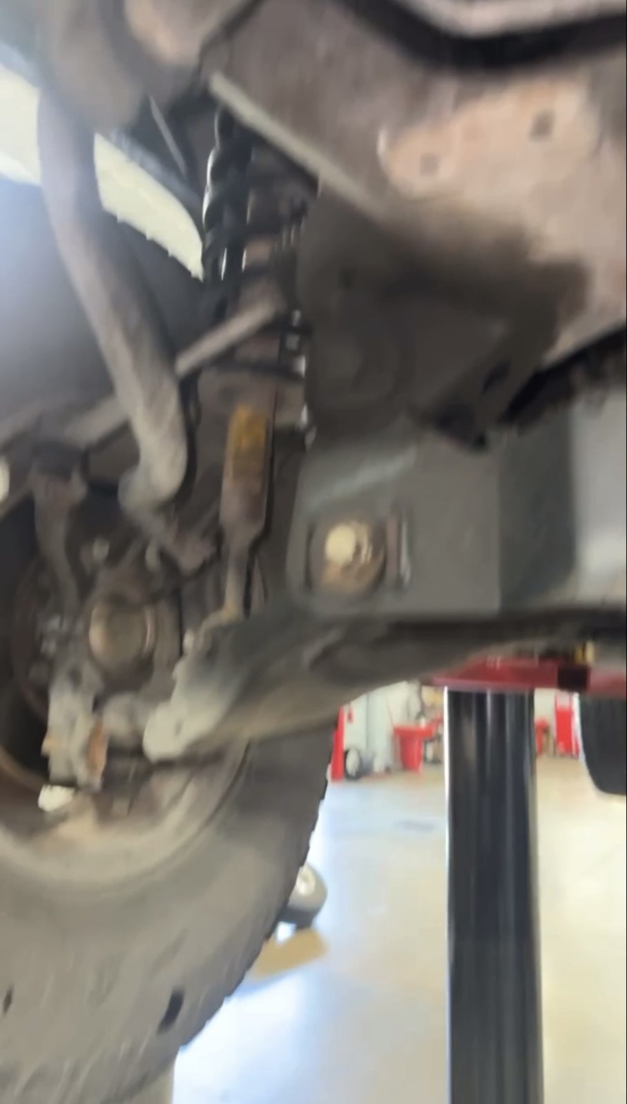

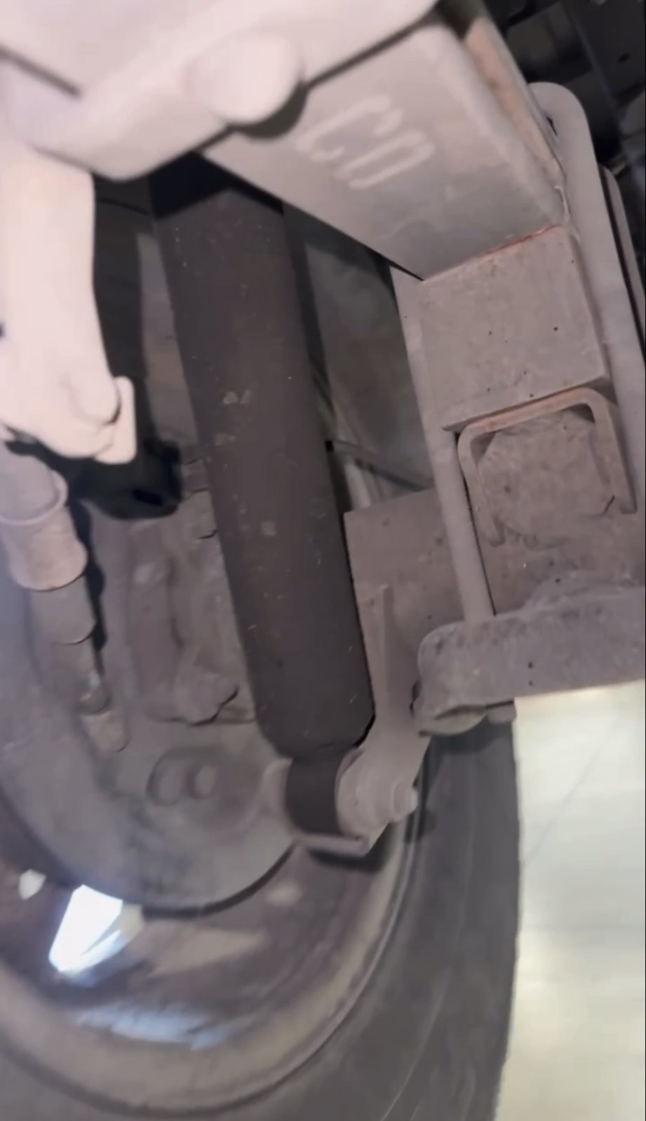

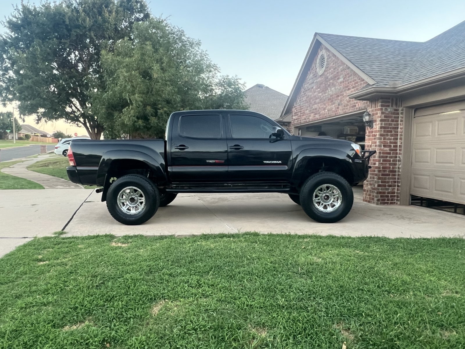

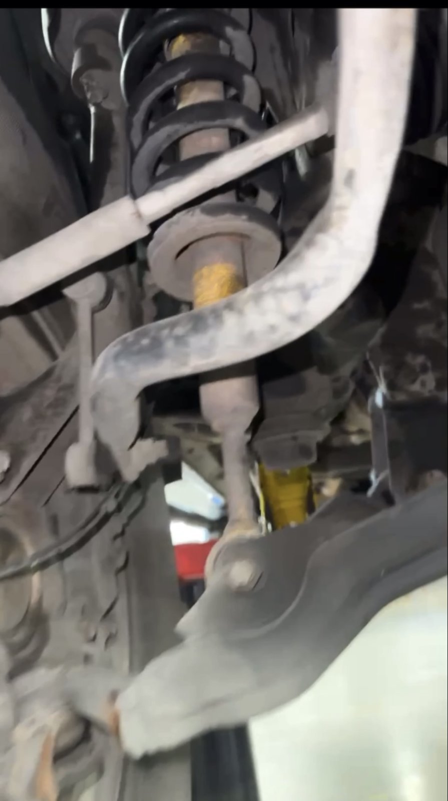

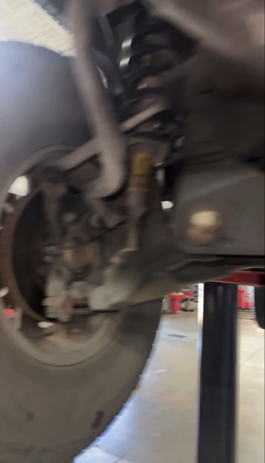

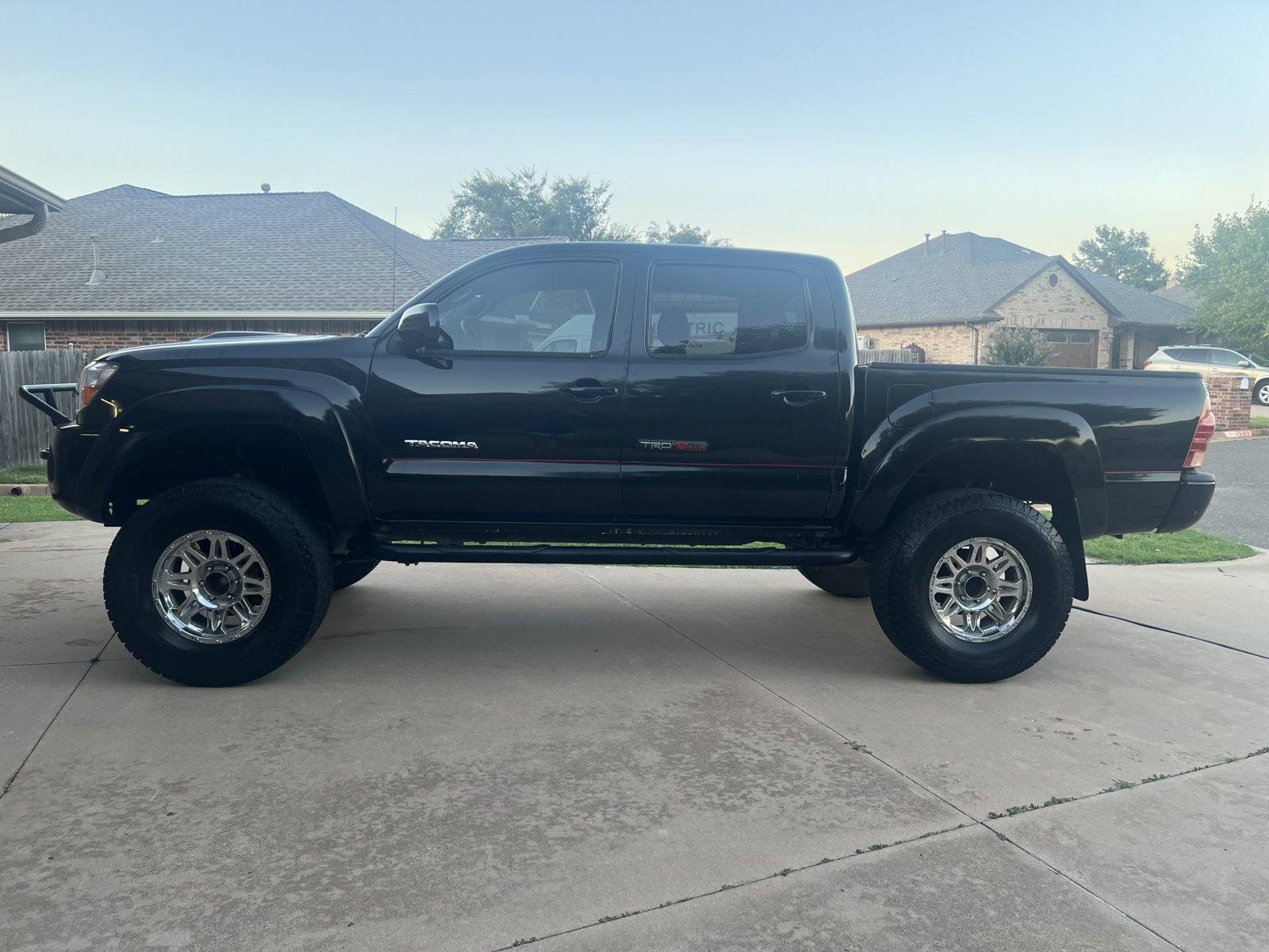

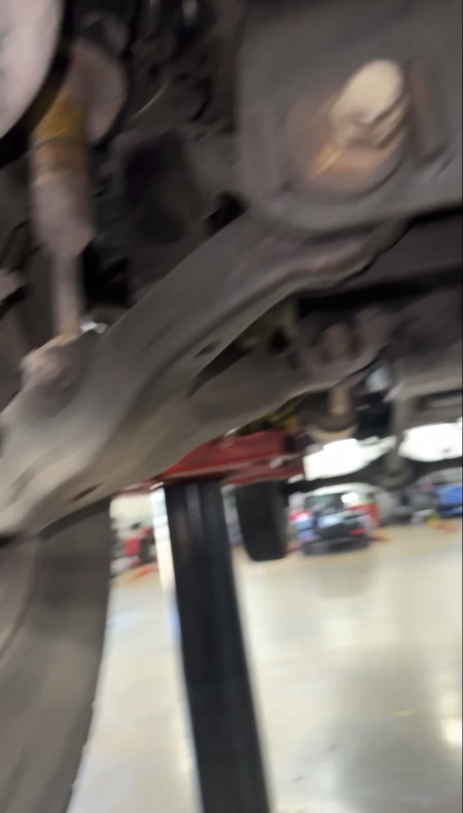

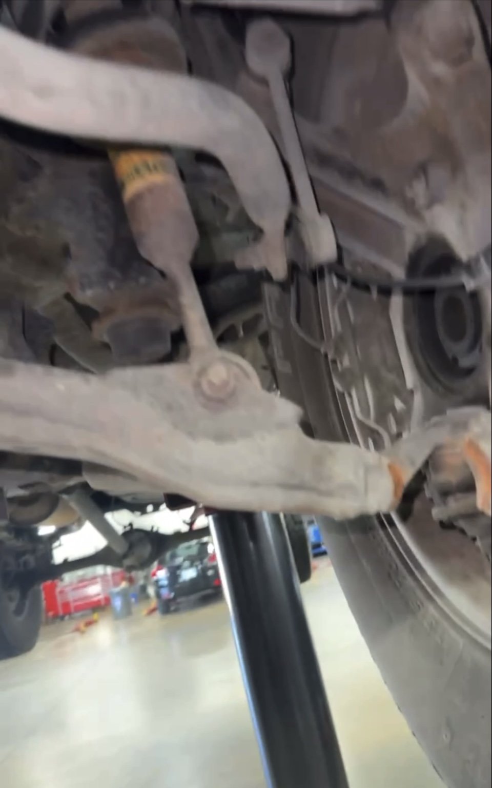

    Hi everyone (this is my first post). Just bought a 2008 PreRunner TRD Sport (pics attached) and I’m wondering how I can determine what size lift it has. Thanks!

    Clear pics of the suspension would help folks advise.
    Suspect blocks in the rear and spacers up front. But the pics should tell more of the tale.

    Take photos of your front and rear suspension.
    Shocks, coils, spacers, leaf springs, etc.

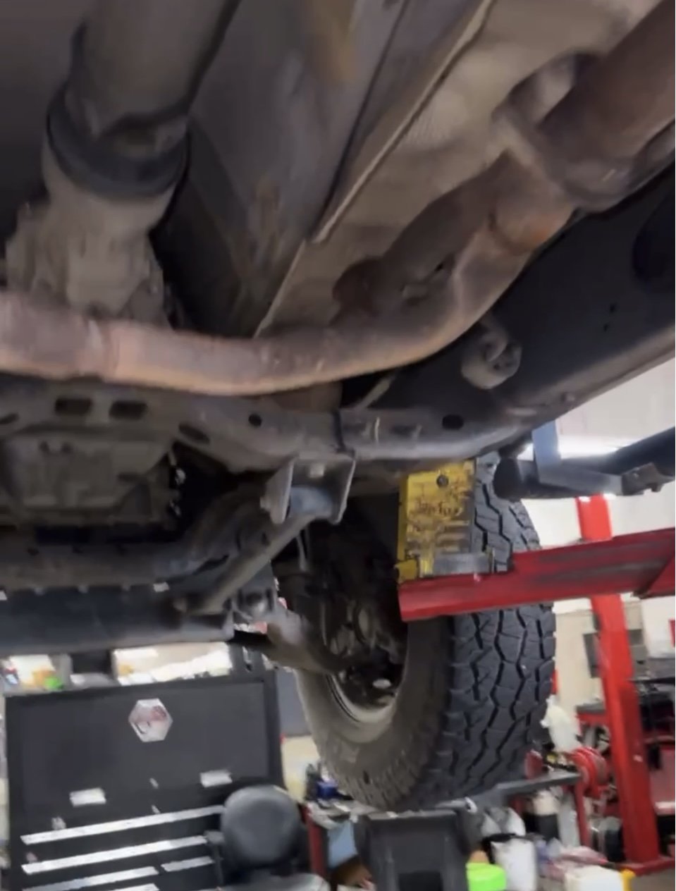

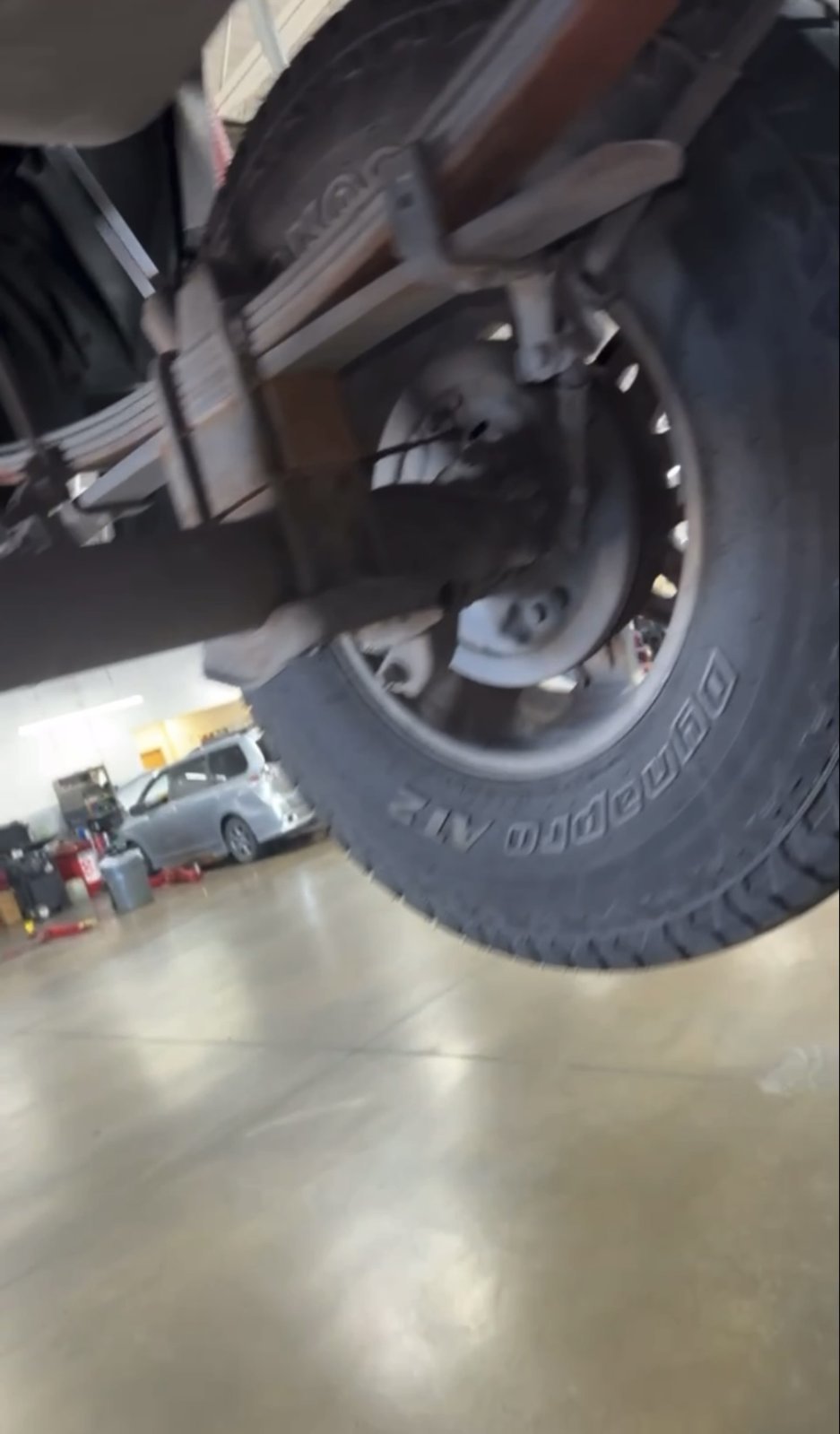

    @Clearwater Bill beat me to the punch. You might also measure the height of the spacers he mentioned. I’m not sure if you can access the fronts, but rear lift blocks should be pretty easy to measure.
    Nice looking Taco BTW.

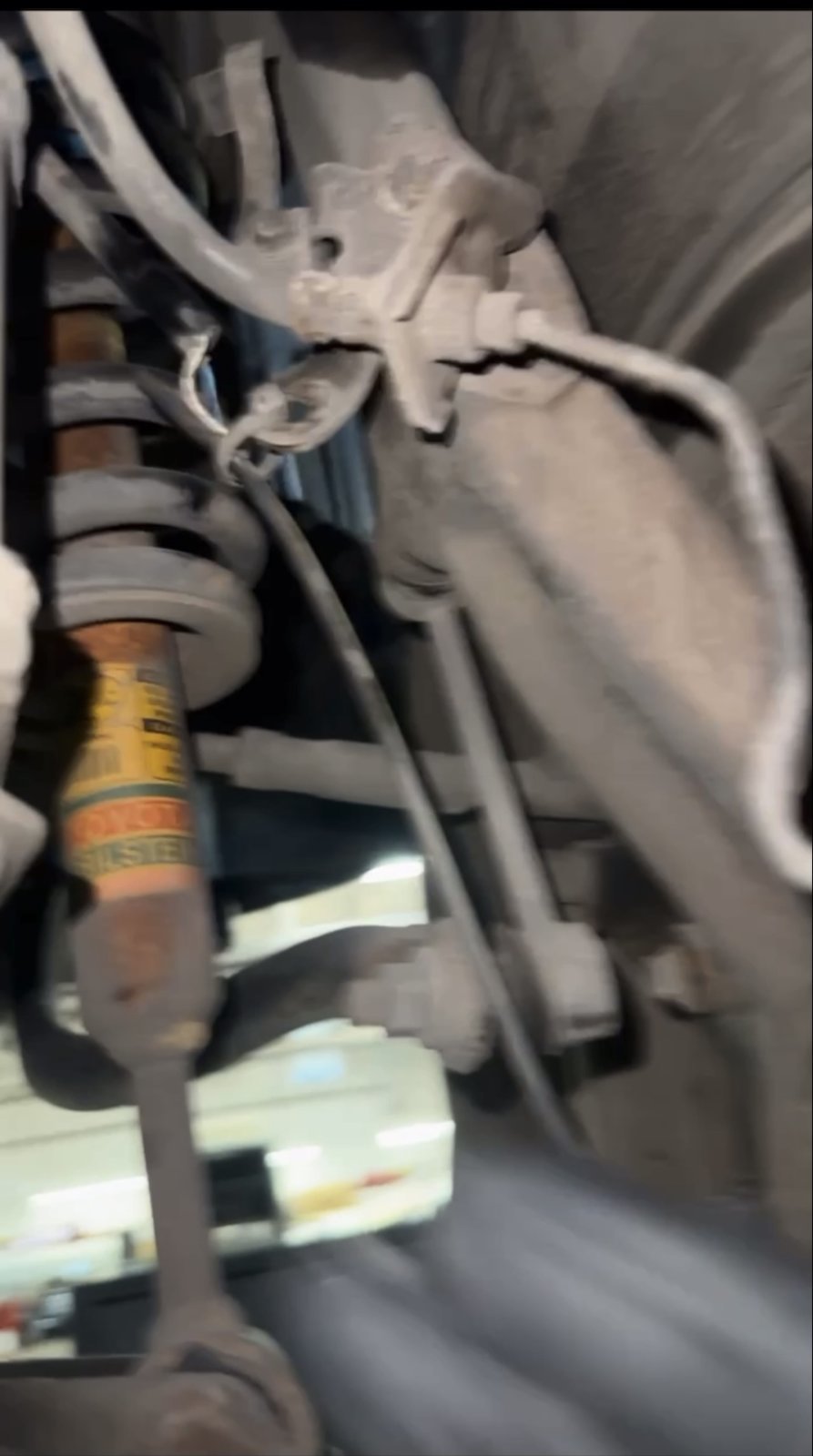

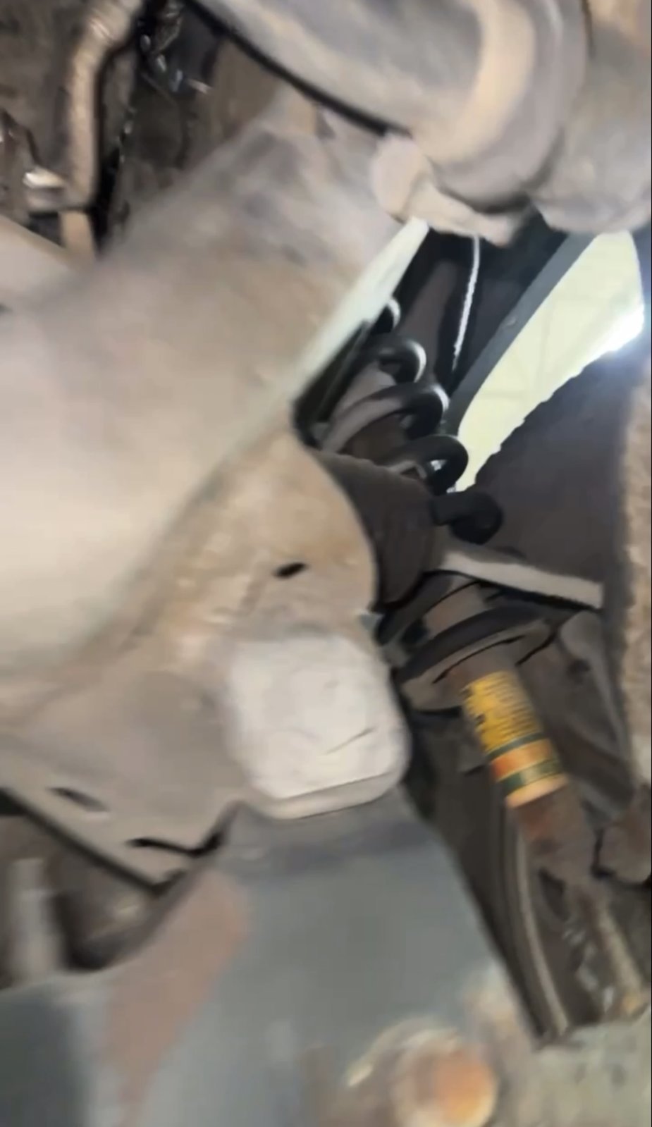

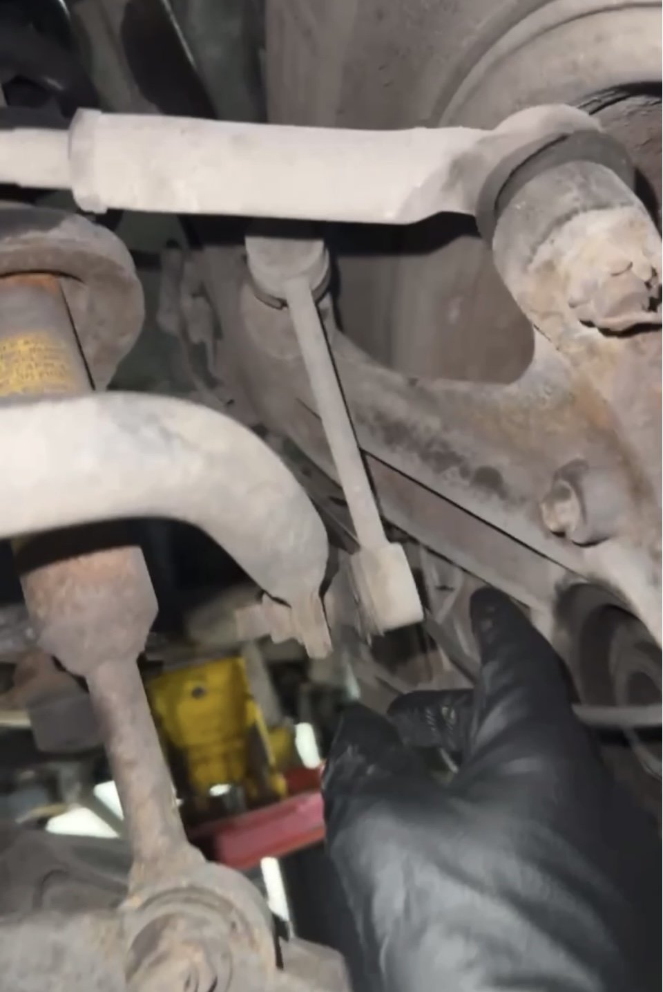

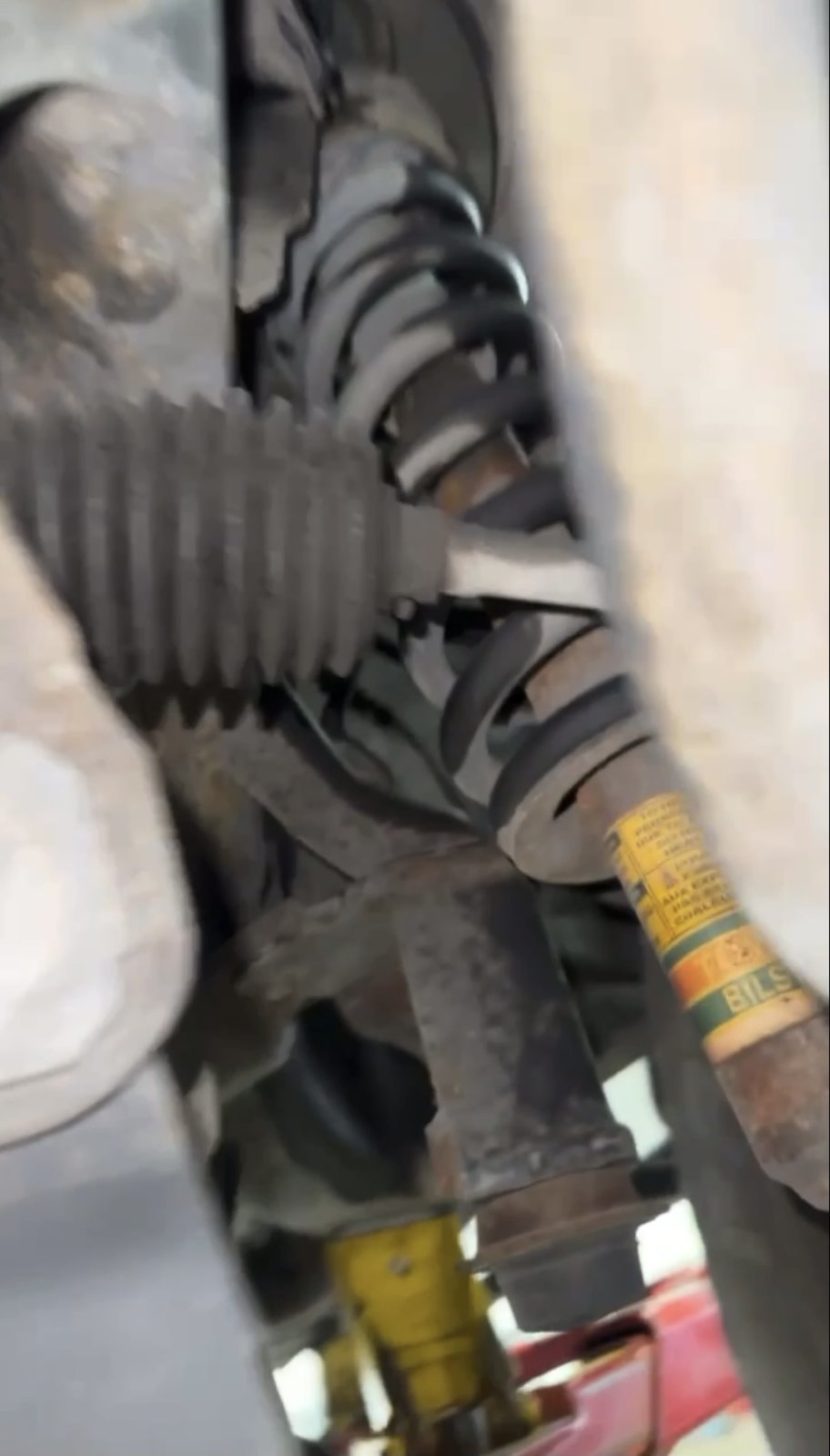

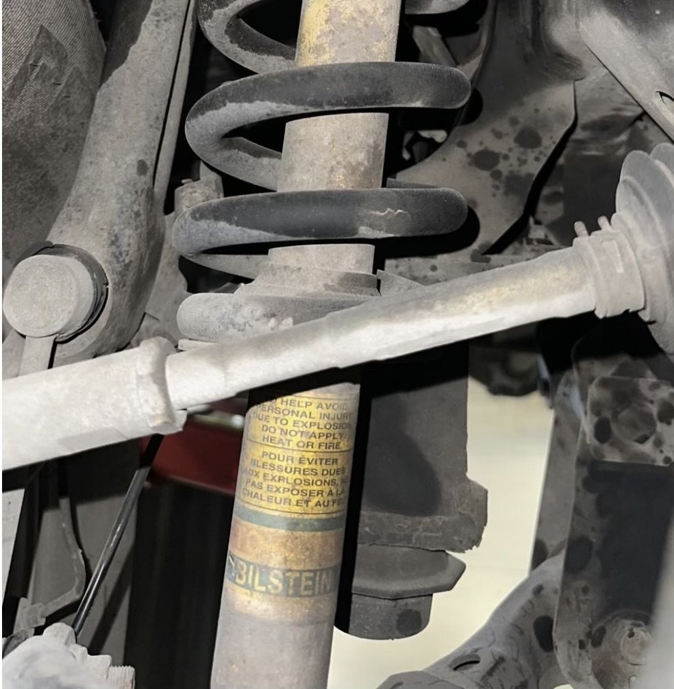

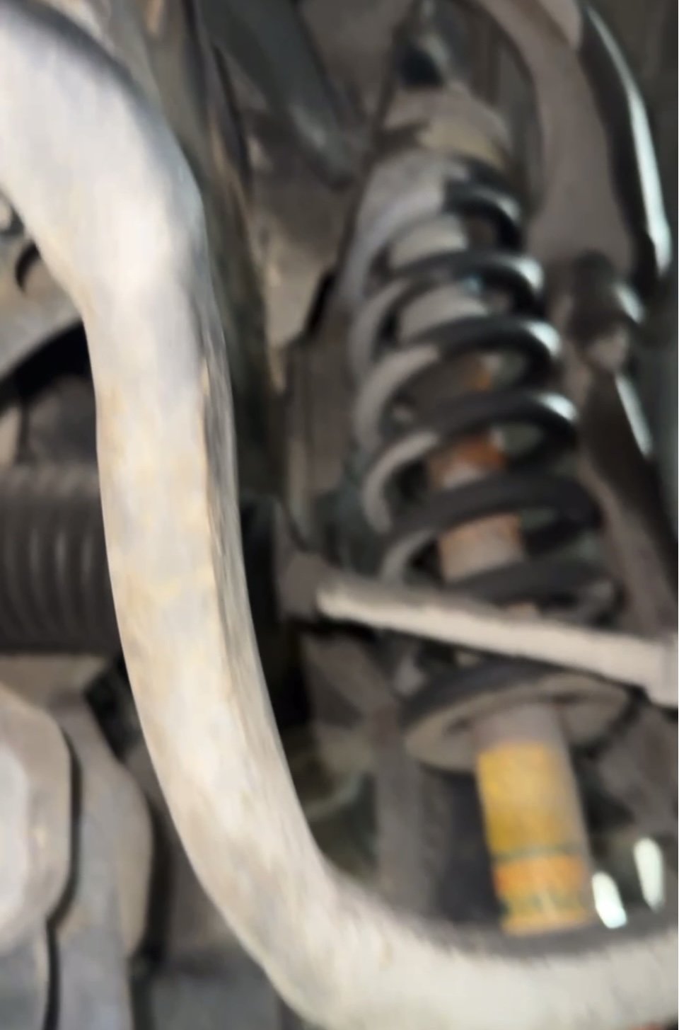

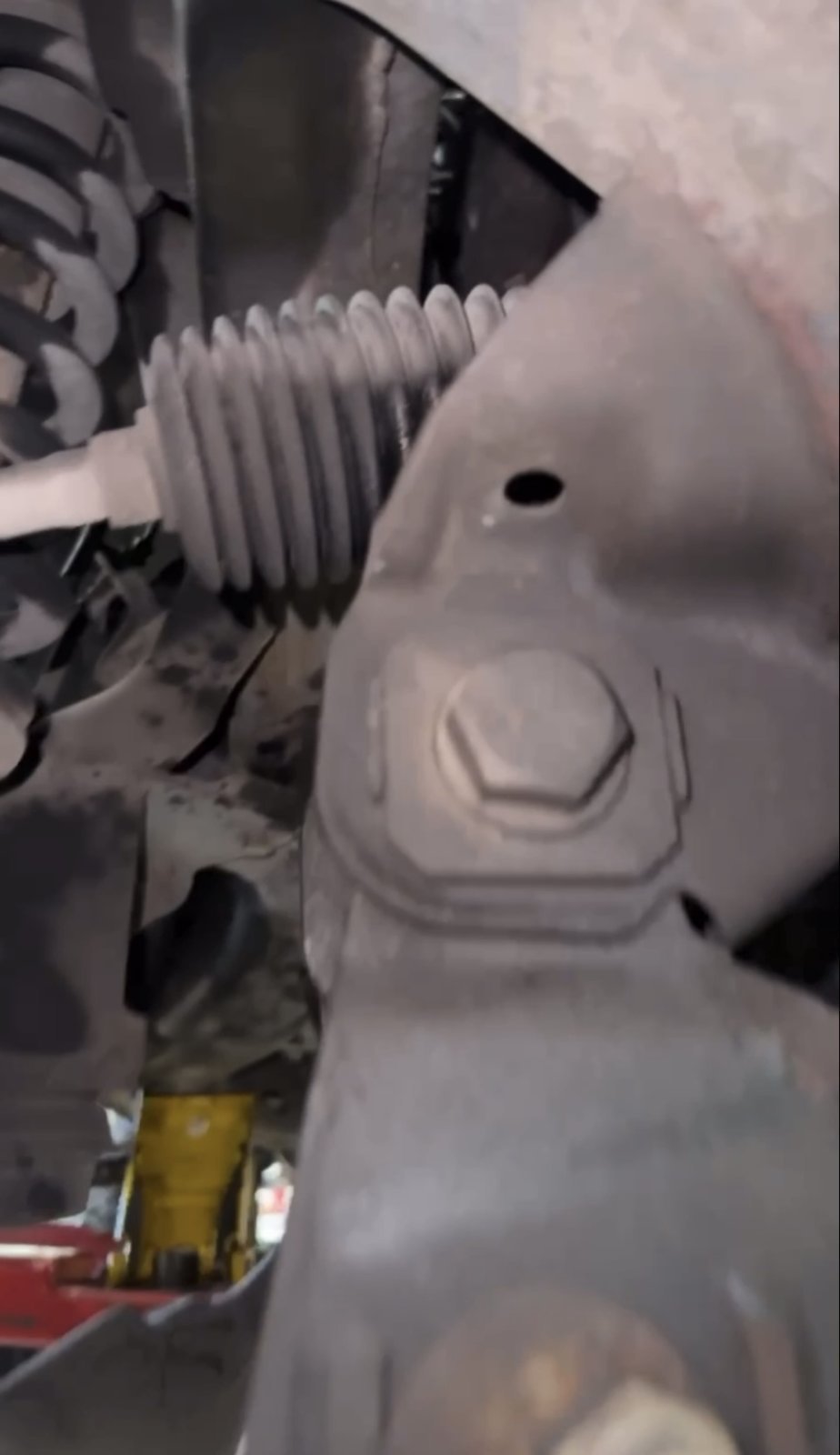

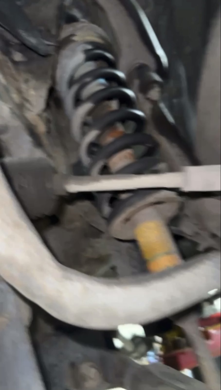

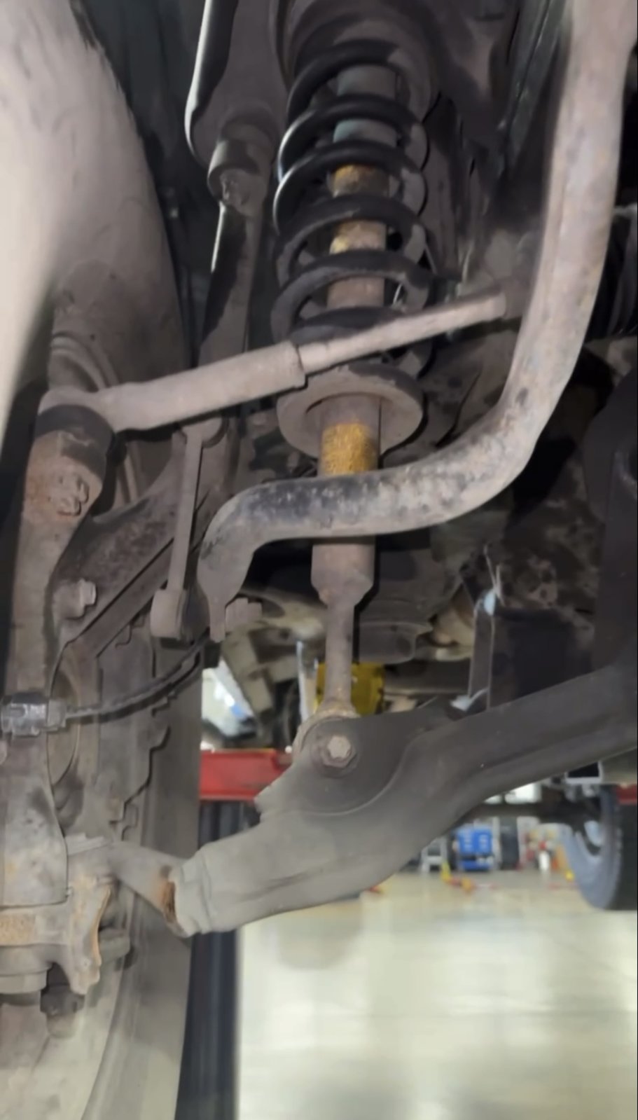

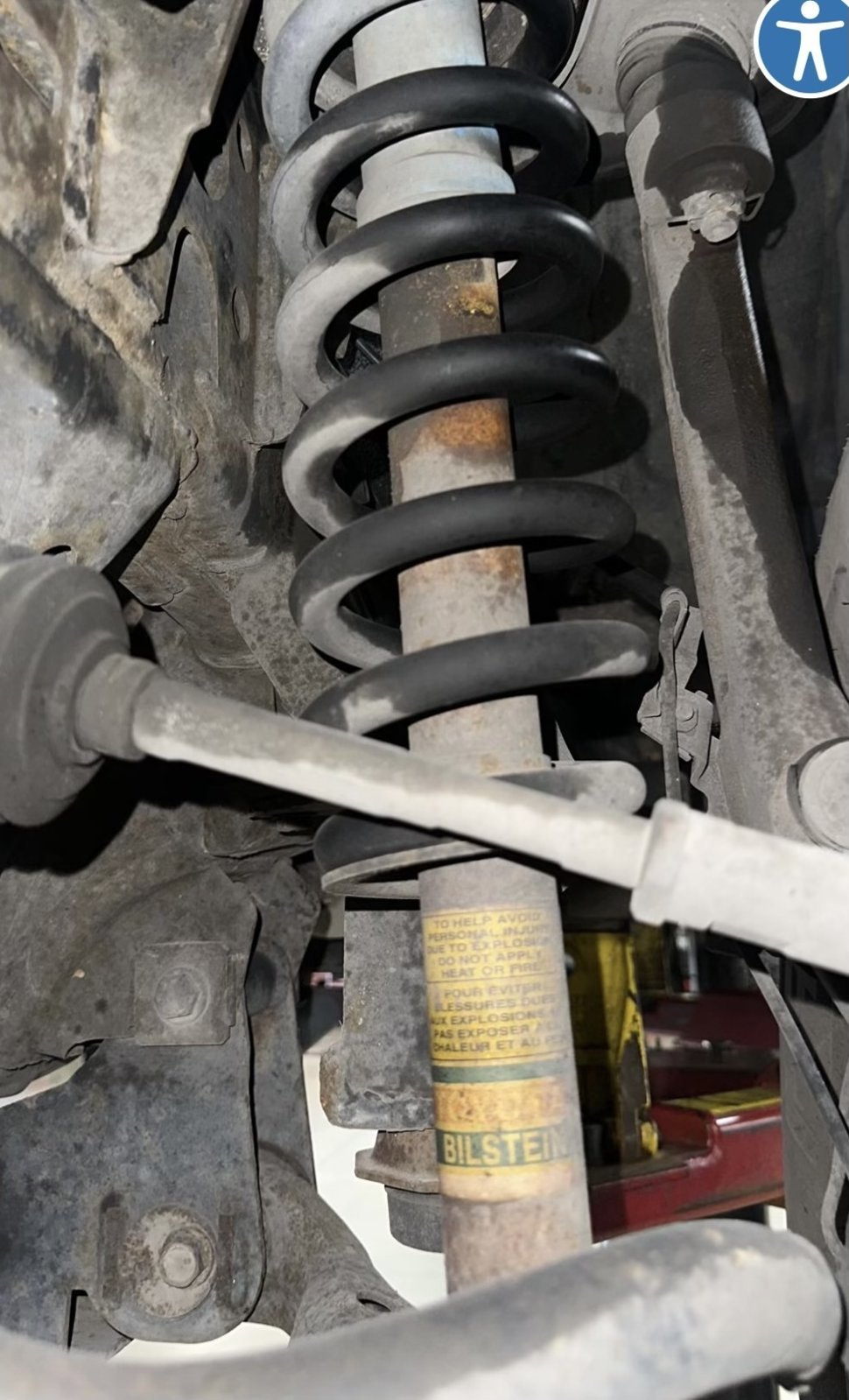

    Here’s some pics that I screenshotted from a video. Hope some of these help.

    Looks like your truck has a body lift, a spacer lift and bad shocks. BTW, those pics suck

  8. Aug 20, 2024 at 10:01 AM
    02hilux
    02hilux What do you mean there’s no road, I’m here
    Sep 14, 2016
    #197244
    6,305
    Planet: EARTH
    6” drop bracket lift
    Grey 2015 and gotoman1969 like this.

    Thanks for the replies! I’m getting quotes on new shocks and struts.

    If you leave the lift blocks on the back axle, you’ll want some very good shocks back there. They act like a lever and the axle housing tries to roll and wrap the spring when you get on the gas. It can get hoppy on acceleration. It’s not the best way to lift a truck on a leaf sprung axle, but it’s been done a zillion times. I’d be gentle on the go pedal.

    It's 2024. The cheapest smartphone out there has a 5 megapixel camera in it.
    There's a federal law against taking photographs with a potato.
    You just violated that law.

    Yeah those pics are tweaking my eyeballs (you said they were stills taken from a video... Does whoever video'ed that always hold the camera 0.2" away while recording?).
    I'm going to say it's a 4" lift, based on the 2.5" or so apparent height of your rear lift blocks. Those pics are too crappy to tell anything beyond that though (such as what kind of lift it is). You need to retake the pics from a foot or two away so that more of everything can be seen.
