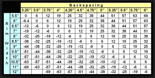

    The progressive will not necessarily give you more lift than a single, you should get between 1 1/2" - 2" with either the progressive or the single. The progressive will give you a better ride. A single would be good if you have a lot of weight in the back.
    Make sure that the tire you do select will fit on the wheel that you want to use. Look at the tire manufacturers website to get the specs of the tire and the wheel width recommended for that particular size.
    On a 18 x 9 wheel, 4.5 backspacing would be around -12 offset. See the chart below:

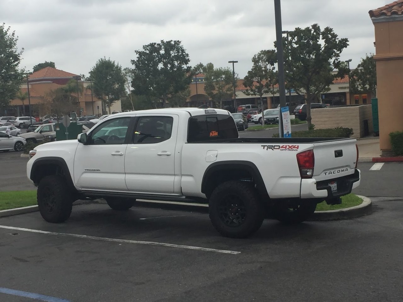

    I just like my truck and since the thread's about lifts, here's mine.

    What's your setup

    Kings and TC UCAs up front and single AAL/Kings in back. I set front to level to the back.

    Nice I'm looking to do the same just with a toytec kit most likely What tire size are you running and how much lift did you achieve over stock

    I went with 275/17 KO2s and I think I'm at 3" over stock.

    Have you taken it off road yet? If so any rubbing? I'm looking at the same exact kit but want to make sure I'm good for no rubbing off road. Also do you have the adjusters and if so is that how you leveled front to match back?
