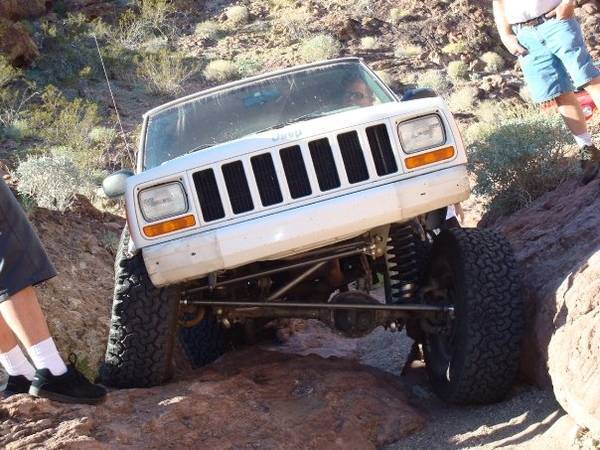

    Pictured above is true wheeling and like I said a true enthusiast should know the difference. No one going out to the dunes or desert to run at high speed refers to it as "wheeling". So your tacoma isn't going to have issues with the CV's binding in a situation picture above? Ok. The problem doesnt come from running around at ride height, it rears its ugly head when you have one side drooped out with a setup that already creates a bad angle, apply torque... pop..clickity klack. As a true enthusiast I'm sure you've heard of King of the Hammers where they run high speed desert stuff and rock crawl, well they are jacks of both trades and while I don't really follow their sport, every rig I've even seen has had straight axles. So go figure. I appluad your use of high quality parts, but uni-ball uca's should be recommend even if it was going to be a road queen because of the poor upper ball joint angle at ride height that your set up would create. Long story short, if you wanna do it right; you're gonna spend more than 3 or 4 grand, straight axle or not.
