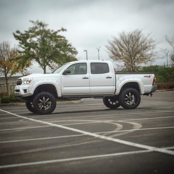

    Say what you want lol but I've seen plenty of tacos sitting on 20's that look damn good
    Just like this one
