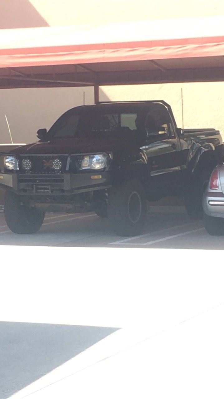

    Hi, i was curious. My truck sits on a pretty noticeable rake at the moment with 2.5” in the front and 2.75” in the rear. How much more lift would i need in the front to make her sit level?

    Current lift specs?

    Rancho quick lift 2.5” in the front and old man emu recreational leafs 2.75” in the rear

    Rip out the Rancho lift and install 886 coils with OME shocks. Done.

    OP, I doubt your rancho lift is designed for the extra weight of your bumper. 886 coils have a heavier spring rate (660lbs) compared to the other OME coils (590lbs I think). This will help keep your front from sagging.

    Depending on your budget, I would swap for some Light Racing UCA's. You know, get some quality parts under that quality truck..

    The ranchos hold up pretty good, i do need to get control arms but im waiting for the fox shocks i have to sell. I’m mostly trying to get a plate or something similar to level it until i can get the cash to get something permanent.

    Could just do a 1/4" top plate spacer if you absolutely need it. That's a lot of weight up front, though. The best option would be what I mentioned before; 886 and OME shocks.
