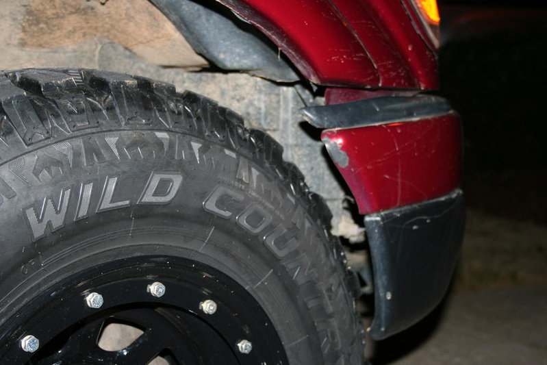

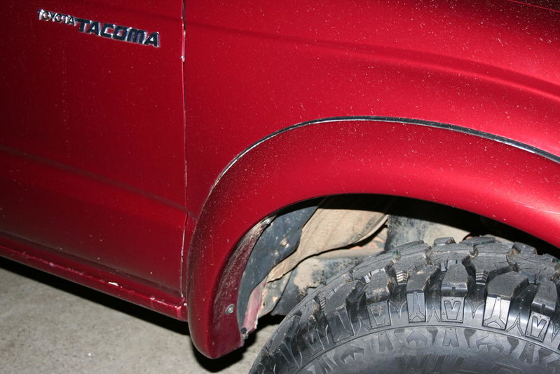

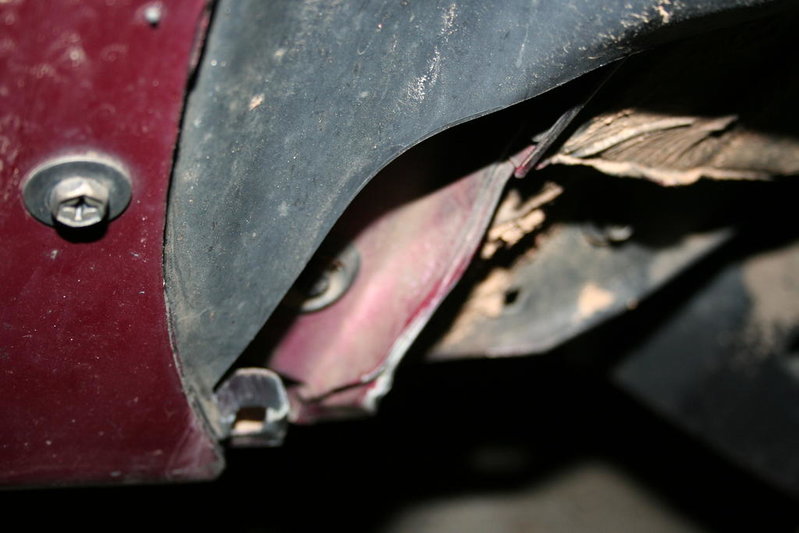

    look in the left side of the wheel, it is rubbing on the frame it looks like.

    pinchweld is that white thing in the back, just hammer it down son

    getting a lift WILL help with that. bilstein 5100 adjustable front shocks, with your choice of ome 881 882 or 883 coils or eibach coils.
    Now go search using those words and you're set. bye!
