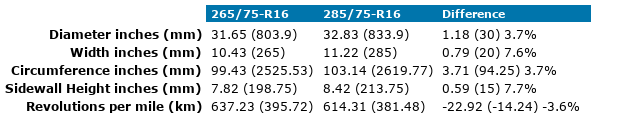

    every truck will be a little different, different wheels, and different brand tire specs are a little different, also. I know people running 285's in the off roads that have done nothing and have very little, if any, rub. I have a limited with a 2.5" lift with 265/16's and I have done a lot of trimming just to get full travel without rubbing. I would need to do the cab mount chop for sure to run 285's, but that's a lot of work for what, not even a 1/2" gain? Plus going from 265/16 to 285's cost more per tire and is adding a lot of weight. I'll probably go to 255's and taller sidewall, if anything. Guessing you have 17" wheels? So, you will need to compare specs.

    Yeah, I've got 17s. Ultimately I want to be able to run 33 inch tires with as little rubbing as possible

    Well, if you are looking for something in the price range of whatever that crappy kit is you listed, better to just leave it stock. If you are set on a 4" lift(or really a TRUE 3"lift), you are gonna need deeper pockets. Running over 2", you should really get UCA and a sway bar re-locate. Over 3" you are looking at also getting Lowers and probably a diff drop.
    If you go with a skinnier tire and taller sidewall, it will be much easier to stuff in the larger diameter tire without as much work and stay with a 2 1/2 or 3" lift.
