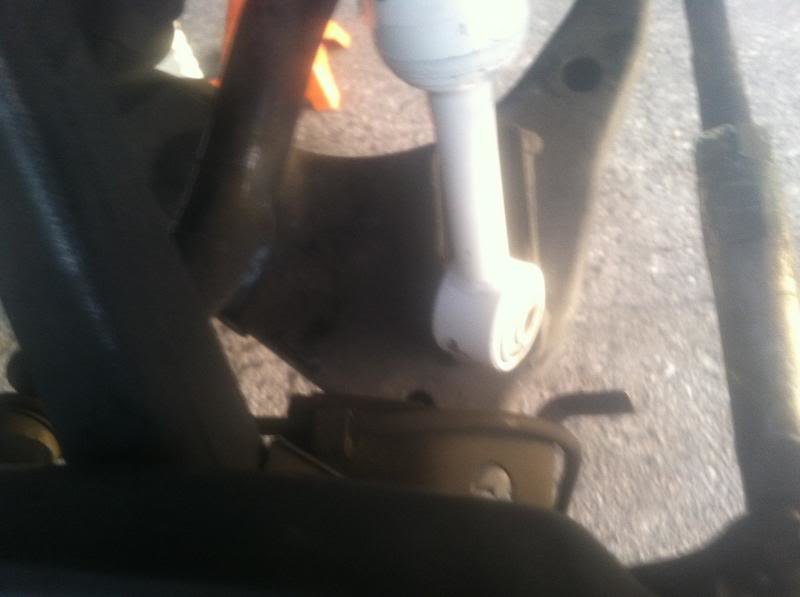

    I'm installing a pro comp 3 inch lift in my tacoma I got the driver side coil over in which was a pain. But now I'm stuck on the passenger side. The bottom of the shock is crooked about a half inch and won't line up. I've taken the spring off 4 times now to line it up but same thing every time. Any ideas please and thanks in advance

    Here is a snap shot image_zps460cc00c_acfad52dcc42361b3cff25d326e4c5958b327737.jpg

    Weird...mine were off about that much when I did mine, rotated just fine. Helped another member do his, same story. I run 5100's, he has the Iron Man shocks...both of these use a "floating" spring seat, not sure if that might make a difference?

    crap, without a floating (free to turn) spring seat, it will be difficult to turn that. short of removing the coil and trying again, I think it will take a lot of force.
