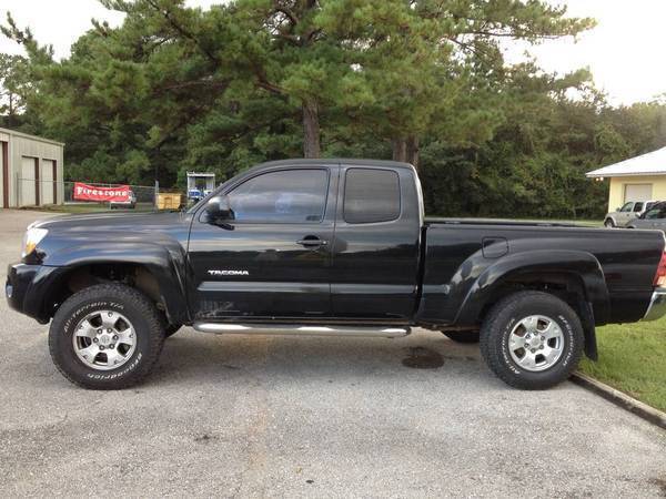

    Ok so I dropped my truck off Friday at the shop to have my OME lift installed.
    Specifications: 885x coils, front 90000 sport shocks, rear N128 shocks, and a 2 inch Deaver AAL. (I have 265/75/16 tires)
    I went by and checked after they closed yesterday. My truck was sitting there, the lift was on, but I guess it wasn't aligned. I can't get it until Tuesday. As you can tell, it has a pretty major bro lean. As I've been looking at other members trucks with the same lift, I noticed that they seem bigger than mine. As for the bro lean, I checked out the rear, and the add-a-leaf was just sitting on top of the leaf pack... Isn't it supposed to go on top of the overload? Is that the reason the rear doesn't seem to be lifted much? Also is it just me or does it just seem a bit small for a $700 3 inch lift(compared to others)?

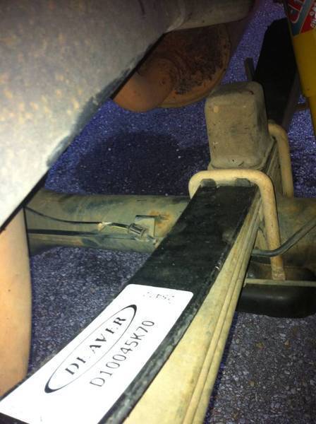

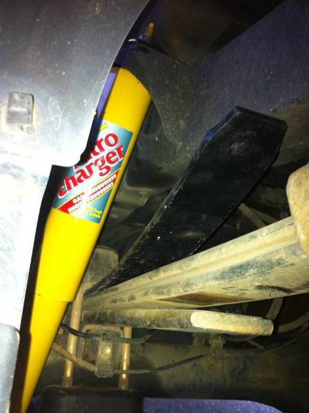

    Sep 3, 2009
    #22227

    How do you mean the AAL was just sitting on top of the leaf pack ?
    885's no top plate spacer should get an AC 2 3/4 - 3" of front lift
    Did you add the 5mm trim packer , driver's side ?
    The only way to tell the actual amount of lift is before and after hub to fender measurements

    It's the tires that make it like small. Most people run 285's with a 3" lift.

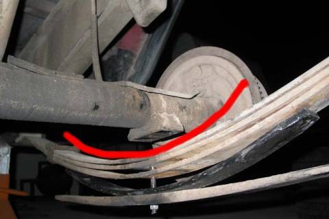

    Alright here we go. In this pic, you see where the actual AAL is. The red line I drew is where they stuck mine

    Is there a chance the AAL's were simply laying on top of the leaf pack, so as to be installed on Monday when they open?

    Really? :laugh:
    That's not going to provide any lift.

    ^^Yup...wrong spot for the new leaf.

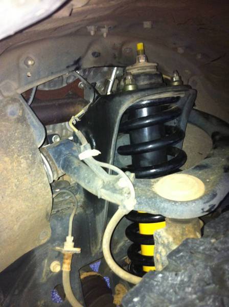

    Good evening everybody! Well I asked my mom if I could borrow her 09 BMW to go check out my truck (long shot I know!), but it worked!! So I put some gas in it and drove down to get some pics for you guys.
    Here's what I got. The leafs are in fact installed.... wrong hahaha. I also to a pic of the front. Everything looks to be fine but I will be asking them to check the torque.

    You've got to be kidding me......
    I would be afraid to drive that thing, wondering what else they did wrong.
