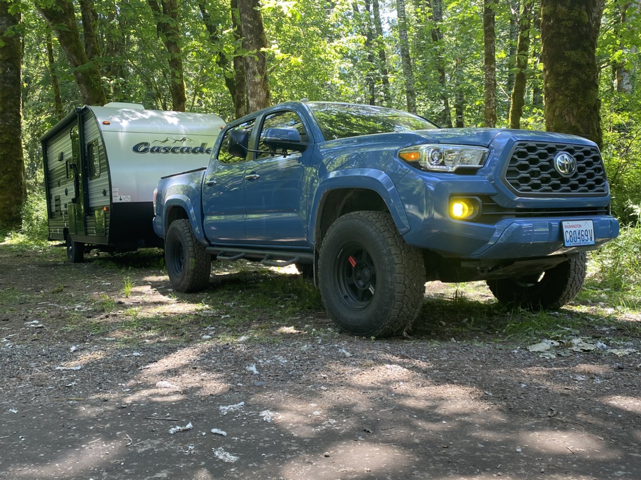

    This might ruffle some feathers but it’s almost Friday. Personally I would stay away from the band aid products and address the issues that the Tacoma has. The factory leaf springs really aren’t designed for load and towing, I would avoid products like airbags, sumo springs and aal products. I would put a good set of leaf springs on it and consider a set of @ARCHIVE hammer hangers. Match the rear shocks to the fronts. I would suggest something at bilstein 6112 or higher quality.
    my personal setup after multiple different configurations are
    Deaver U402 Stage 1’s
    Hammer Hangers
    JD Fab front Uca
    King hydro bumps up front and still running stock bump stops in the rear.
    King 2.5’s with rear adjusters. Off the shelf tune. I run them wide open with no load and usually 7-10 clicks up when towing.
    I have a Forest River Wolf Pup 16bhs and next week we get our new Geo Pro 20bhs. They are 3500lb trailers dry and with an Andersen Wdh I have no issues. I have no need for airbags, sumo springs or additional equipment. The truck works well as a dd, weekend warrior and tow vehicle. Know it’s weaknesses and build around it. Band-aids aren’t fixes, they are just temporary patches.
