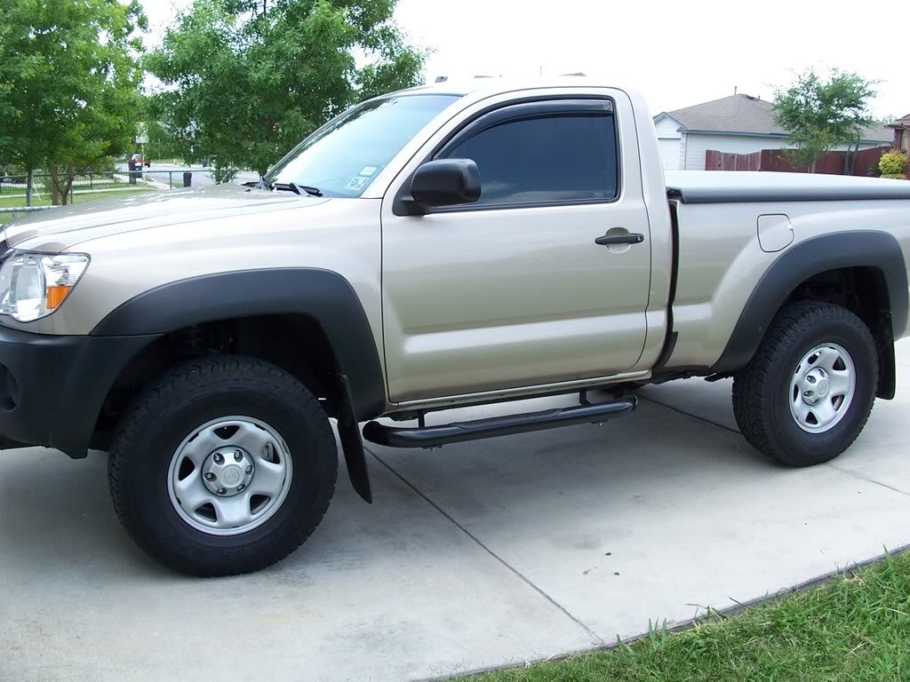

    With Fatbob's 2.25" lift: on uneven driveway.

    sounds like it is meant to level the ride out because from factory toyota has front lower then back . i got one from skyjacker also with ad aleaf in the back. But to reduce axel wear because of lift , there is a diff drop down spacer kit here for good price--> http://www.extremetrucktoys.com/5-6_tac_lift.htm
