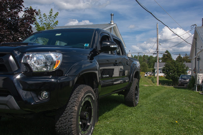

    I went with the 5100's all around set the frond at 1.85 and added a 1" rear block i find the drive just as good as new and maybe a bit better i would highly recommend the 5100's for ride quality and as for axle wrap with a 1" block i have never noticed any issues tacoma.jpg

    885 OME Coils Icon 1.5 progressive AAL Bilstein 5100's all around 265/75/17 BFG A/T KO2 Stealth 6 SCS Wheels
    thermat68, what size tires are you running?

    TRD Shift Knob
    265/70/17
