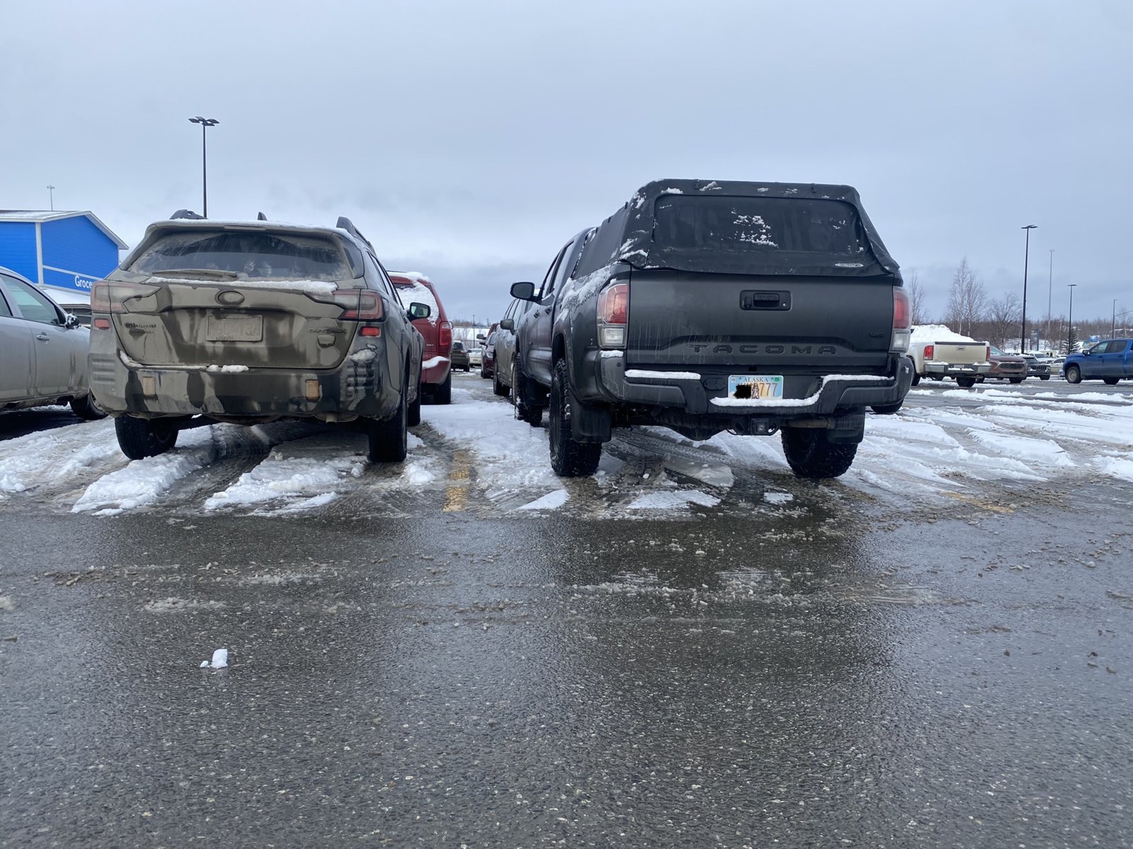

    Case in point.. Subie outback Wilderness has 9.5” of ground clearance, my OffRoad truck Has to sit Higher..
