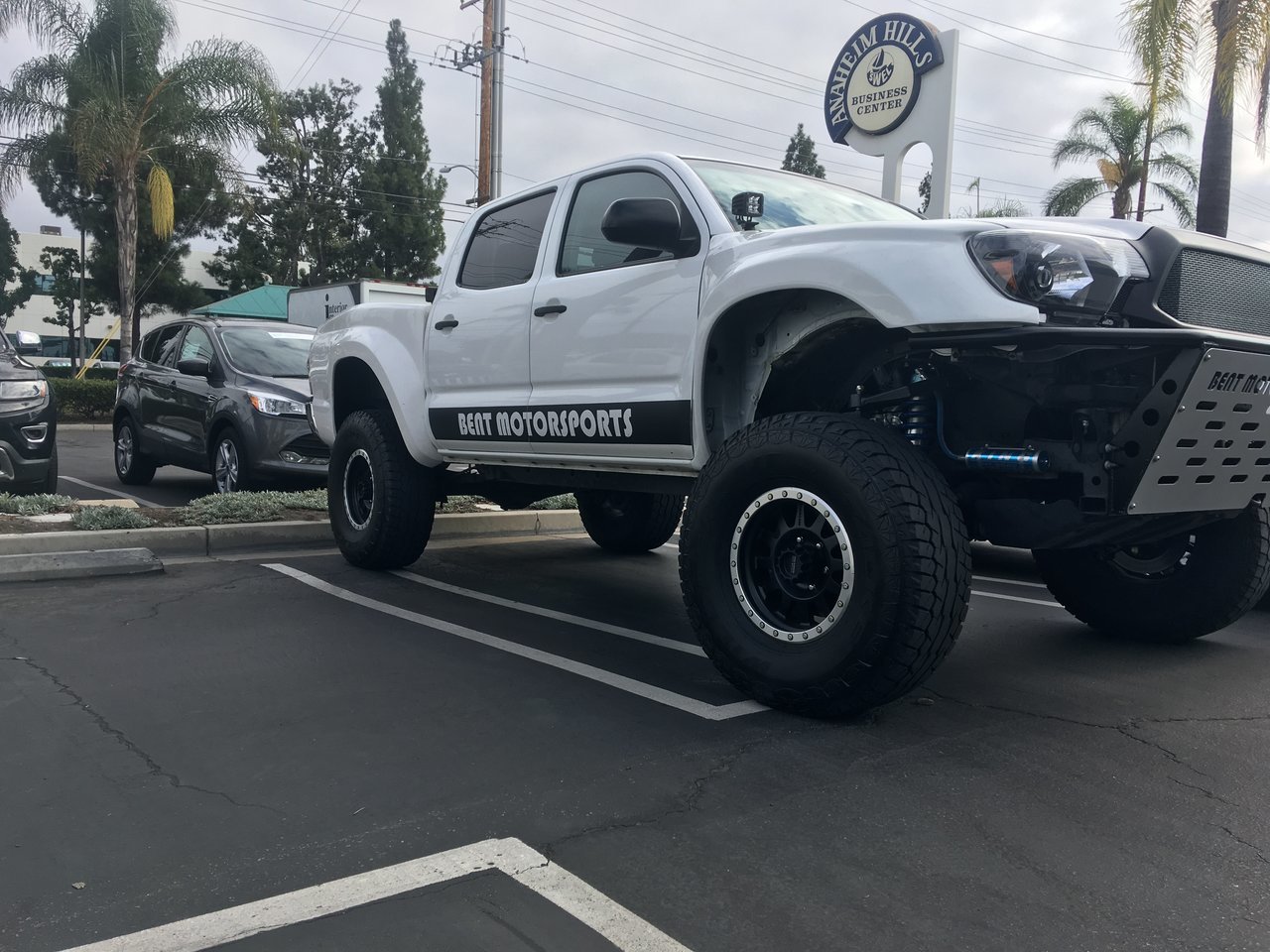

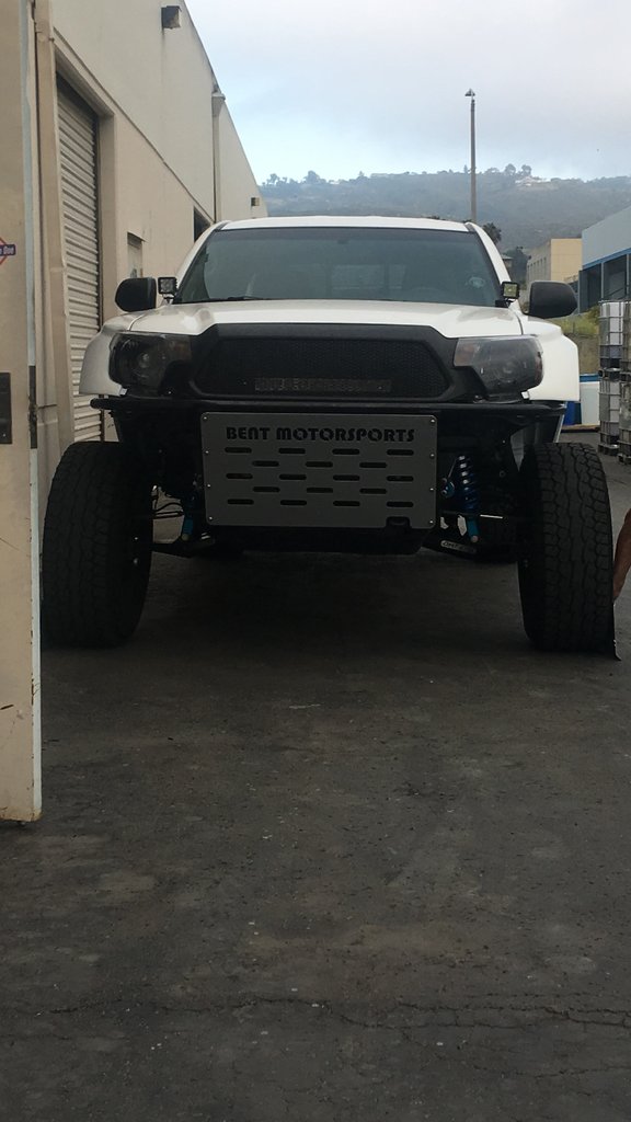

    Im running a dirt king 3.5" kit with maxtrac spindles and its pretty great. Install wasn't hard either

    You're killing me by not posting a picture! Jeez

    Damn, that looks exactly how I dream my truck will look. I originally planned on running dirt king, but I already have icon rear shocks and icon doesn't make a coilover for dirt king. So I ended up getting stuck with the Total Chaos race kit, luckily I'm getting a decent price on it

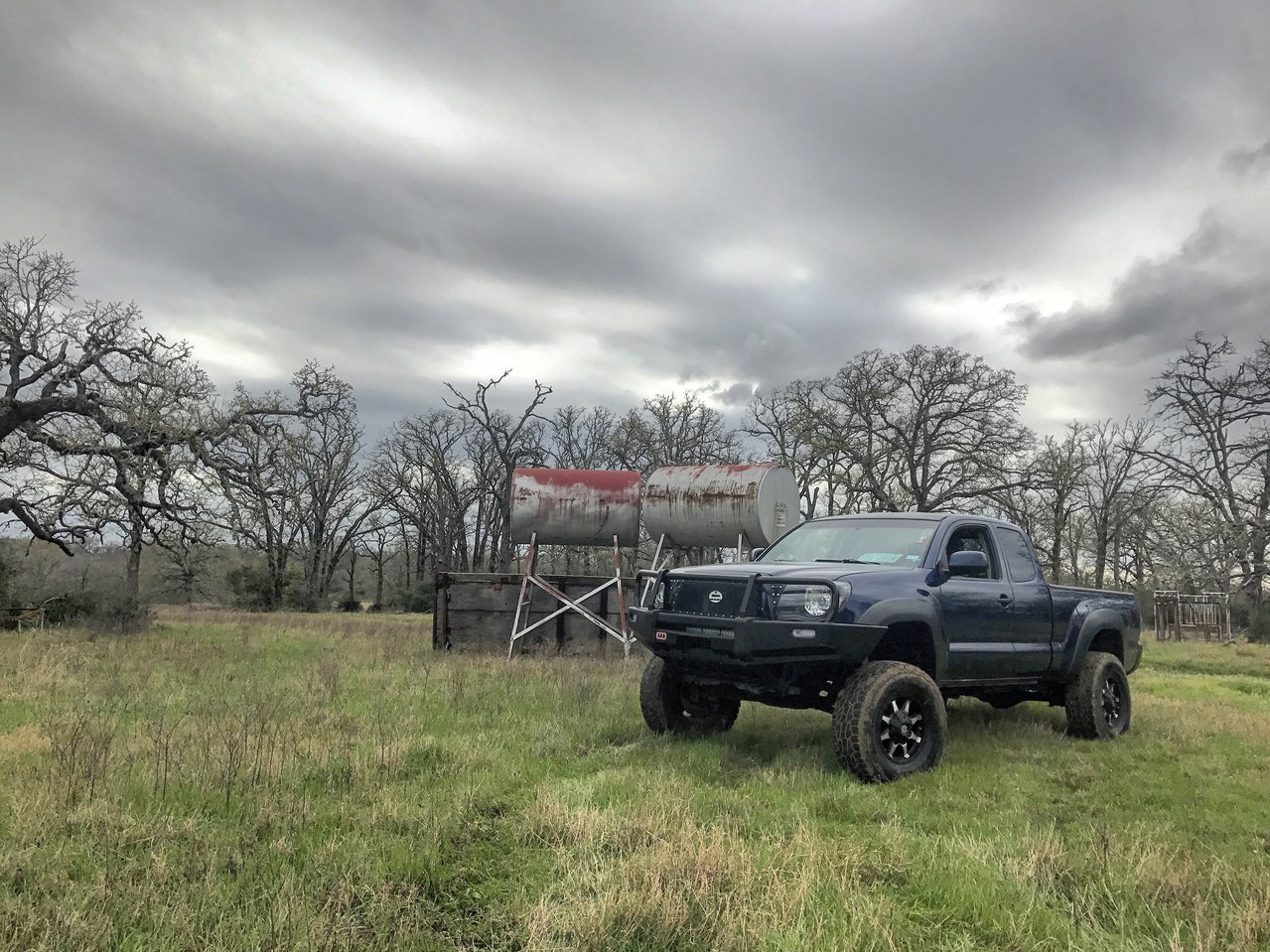

    This is mine right now. I got my coilovers in last week, the rest of the kit should be here next week

    Looks good dude. Yeah i definitely contemplated going long travel for quite some time. Getting myself to spend the money was the biggest issue but when i finally did it, i couldn't believe i didn't commit sooner lol. Look forward to seeing the progress of your build!
