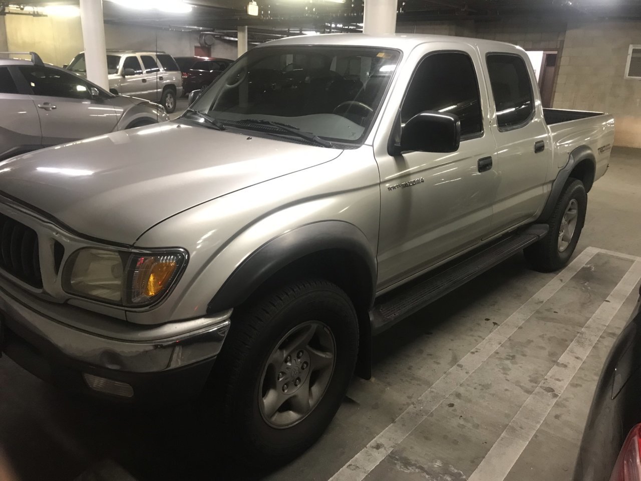

    FAF3090A-20E1-4FA9-9534-67325C02774E.jpg FAF3090A-20E1-4FA9-9534-67325C02774E.jpg FAF3090A-20E1-4FA9-9534-67325C02774E.jpg FAF3090A-20E1-4FA9-9534-67325C02774E.jpg I wanna lift my 1st gen but i need some advice in what get for lift kit and wheel sizes? I’ll like to keep my stock rims.

    Can you post more pics of your truck?...
    What are you looking to achieve with said lift, and how much do you plan on spending for just the lift alone?
    As for tires, you'll have to just do your own research instead of having a bunch of random people telling you what to use. Some like Cooper's, others are Falken fans, whereas some would only have BF Goodrich, etc. This really is more dependent on the type of driving you do, where you live (climate, etc). and you haven't given us much of anything at all.
    With that being said, go with Bilstein 5100's all around or an OME kit and call it a day.

    Ahaha!! Ok well I need some help at least figuring out a nice suspension to take it off roading but also good for a daily?

    Unless your wanting to hardcore off road, rock climibing etc, why not just put a decent set of Bilstein shocks, skid plates, rock sliders, and leave it stock. Less stress on all your drivetrain components, and cheaper in the long run on costs for upkeep. I had thought about lifting mine, but decided to keep it stock. There pretty capable trucks as they come from the factory. If your goal is heavy front bumper with winch, and heavy rear bumper, then OME would be a decent choice without breaking the bank. And one last note, keep a sharp eye on those lower ball joints.

    Dang 2000 bucks for that?? Lol do u know if anything abit cheaper? Like around 600 bucks?

    If you're wanting to stay around $600 I'd probably go with this list, pricing is from Amazon:
    Front:
    $180 - OME 2881
    $200 Bilstein 5100 (24-249928)
    Rear:
    $140 Bilstein 5100 (33247717)
    Spend the rest of the money on an add a leaf or lift shackles. Or save up for new leaf springs.

    That can be anywhere from a few hundred to several thousand dollars, so... what's your budget?
    Best bang for your buck is a set of 5100's from Bilstein, and an add-a-leaf or shackle for the rear. Or you can step up to a set of external resi Kings and Deaver J59 leaf pack for like 3 grand.
    You can daily a $10,000 suspension system...
