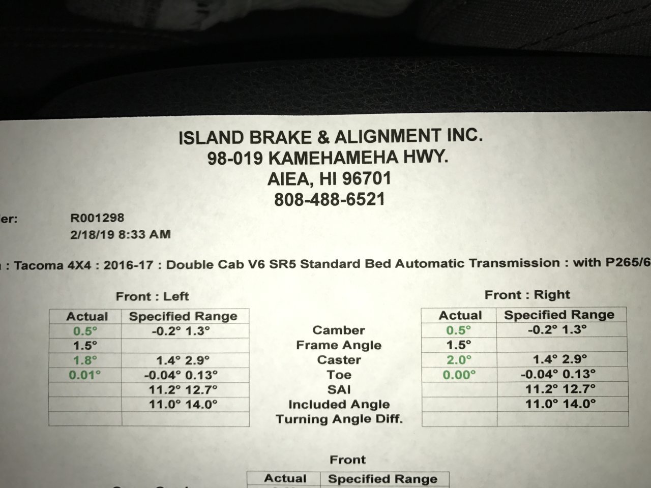

    Running 888s on stock UCAs and just finished up alignment yesterday morning.
    Just to mix in some real world reviews instead of everyone "hearing about needing UCAs with 887s and 888s."
    Don't get me wrong, I will be moving to aftermarket UCAs when I bump the front up another half inch and slap on 285/75/17s (34s) but until then, I think my alignment seems fine.
