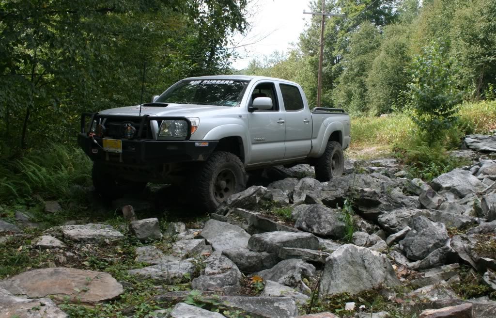

    Check: www.trdparts4u.com They have complete kits or just parts. I have Old Man Emu front shocks with 886 Springs with toytec 1/4" spacer added to top and Old Man Emu/Dakar rear leaf springs with toytec 3 degree shim. This is right about 3" lift and I have had this for a couple years and still have factory rear break lines. I have not heard of "suspension connection 3" lift kit" so I do not know details about it.
    Oh yeah I run 305/70/16 Cooper Discoverer STT's on American Eagle 185 rims. (33.07" x 12.01")
