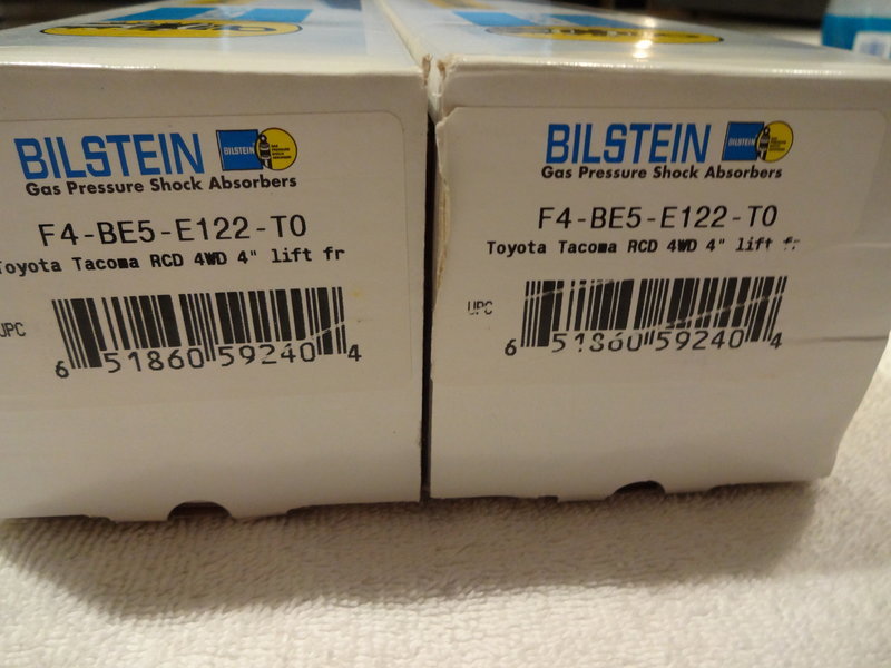

    If you don't offroad much and are considering changing your front factory coilovers I recommend just getting the longer bilstein shocks which are normally used on the rcd kit. F4-BE5-E122-T0. unless you want to spend the extra on more expensive coilovers.
    Like evenflow stated above the spacer doesn't preload your spring like one used on a 2-3" lift. All the spacer does is makes up the difference since the drop bracket lowers your front crossmembers down to help achieve the lift. By using the longer shock I mentioned above used on the rcd lift kit you won't have to use the spacer because shock is designed to run with the drop bracket kit and is longer than the stock ones. I myself have used the longer bilstein shock on my truck when I had it and had no issues at all.
    http://cppdiesel.com/RCDF4-BE5-E122-T0/
