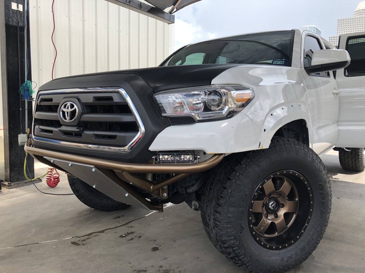

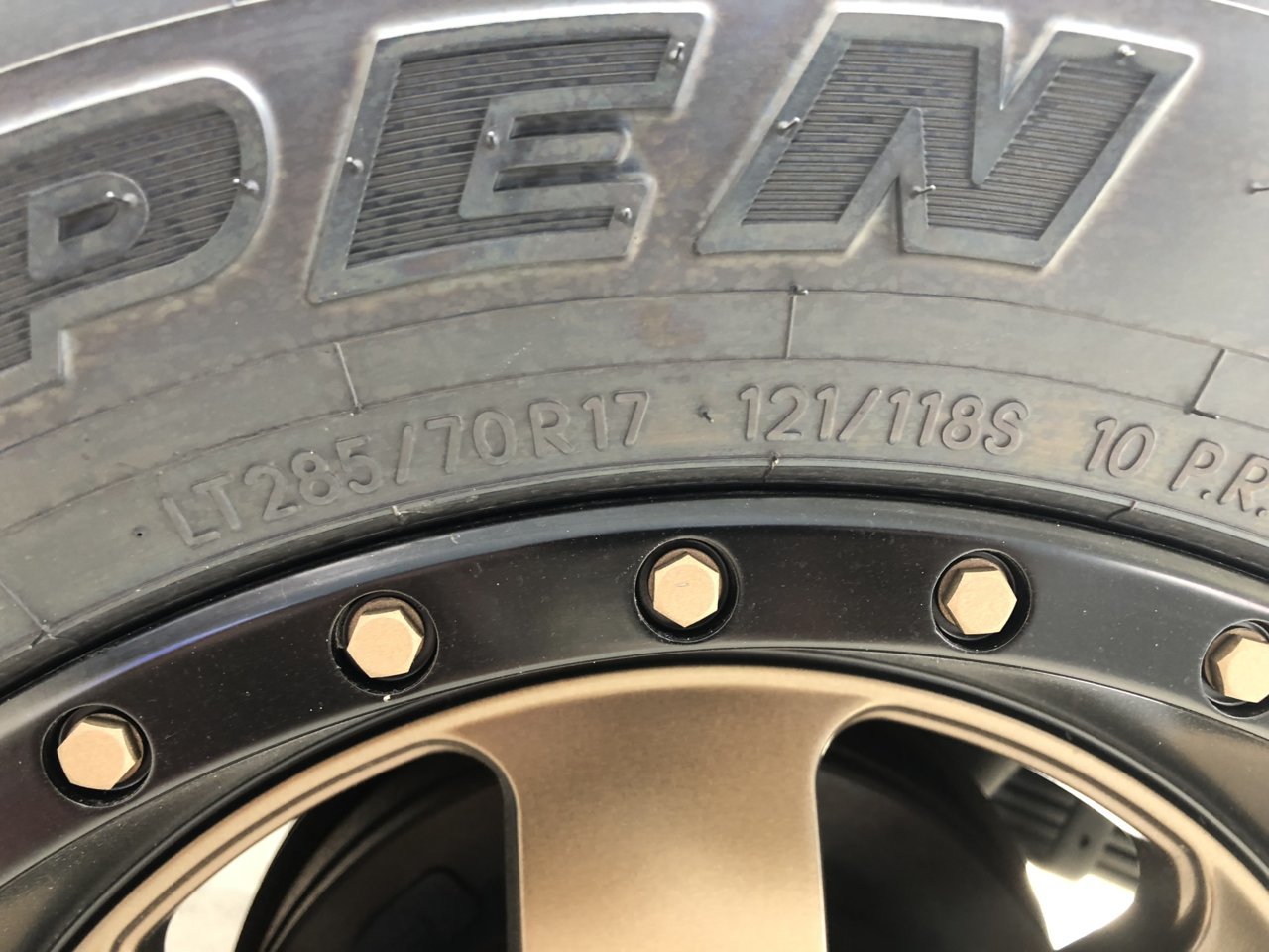

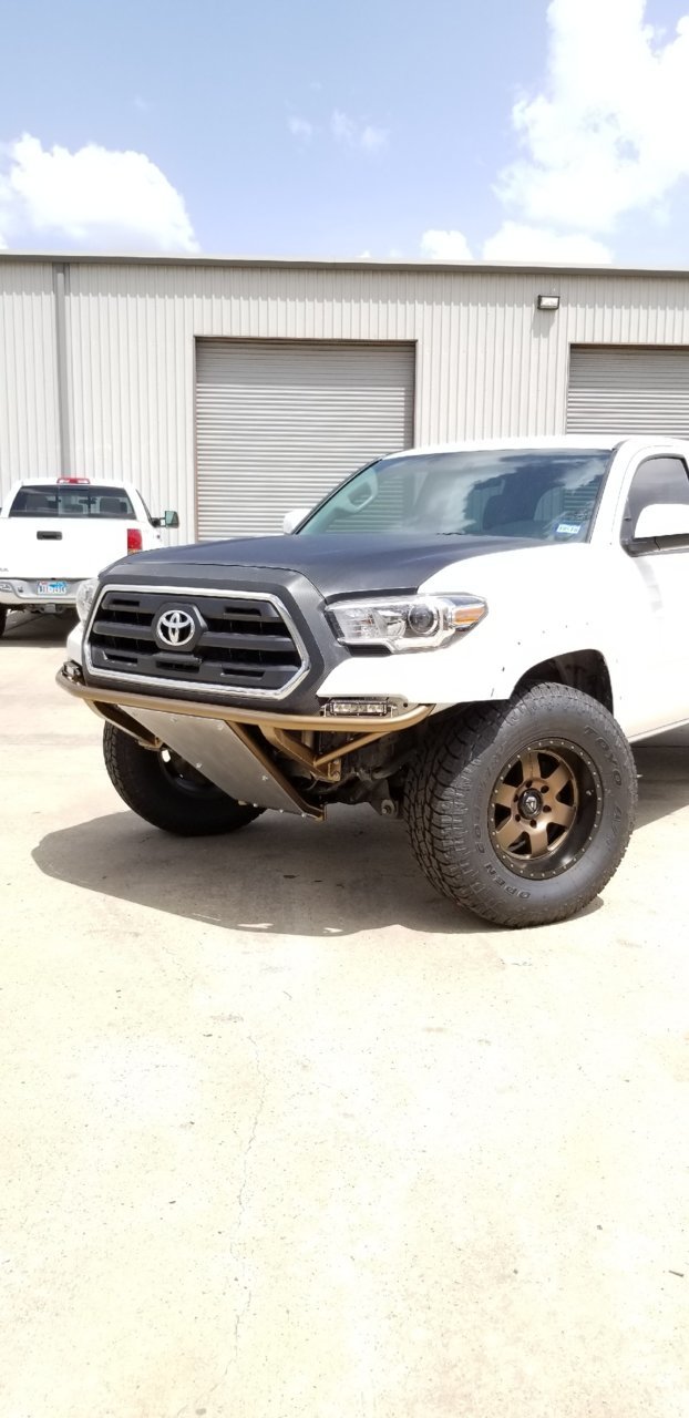

    I just need 2”-3” lift for ride comfort and look. I will rarely do any off-roading with this. It is a 2016 tacoma sr5 2wd. The tire do rub a little and I need to solve that problems. What is the best lift kit for what I am trying to achieve. Below are pictures. I am new to this and do not want something cheap. This is company truck to promote our detailing and protection business...so quality matter as we are the top 3M dealer in the nation. Www.midtownmotortrends.com54FB36F7-F4F7-4328-B13E-3AEFCADE111D.jpg C178D1C8-AB5F-4B6B-AAF6-29DA2F456F73.jpg B8E2B777-0245-4DBF-B40D-D70115A56C9C.jpg 54FB36F7-F4F7-4328-B13E-3AEFCADE111D.jpg C178D1C8-AB5F-4B6B-AAF6-29DA2F456F73.jpg B8E2B777-0245-4DBF-B40D-D70115A56C9C.jpg 71F54FE0-9D09-4D0D-B2A0-3EB2AE36604D.jpg

    I don't offroad much and wanted lift, I got the Camburg Set with Bilstein 6112 front shocks, 5100 shocks in the rear and camburg uni ball upper control arms. To lift the ass you need to either add a leaf or put a block under the leaf springs. The kit was around 850 bucks I think (it's been 2 years)
    The Bilstein 6112's have adjustable rings and I set mine at the very highest setting, got at least 2.5" out of the deal. Sometimes rubbing has more to do with your wheel rim dimensions than lift. I'm not an expert though.

    1.75" or 2" add a leaf in the rear, OME 885 coils, Bilstein 5100s.
    Boom. Cheap and lifted.

    Most likely a lift wont stop the rubbing, you will need to cut the body mounts to fit 285’s. Look up CMC chop.

    It is just rubbing the rear fender lining...it use to rub the front fender lining too until the customer bumper was installed.
