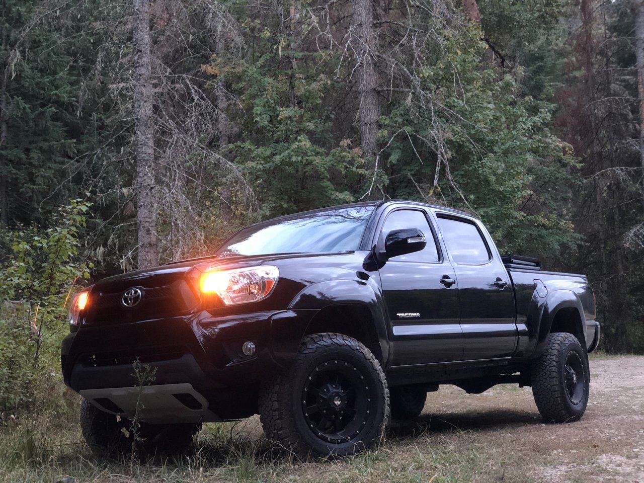

    This is my first post on the forum.
    I just recently bought a 2013 Double Cab Long Bed TRD Sport.
    So far I love the truck but I have to admit that I have already had way more issues with it than I’d like.
    I’ve replaced the carrier bearing (and all the u joints while I was at it), the rear leaf springs seem to be shot, and I am pretty sure I’m getting a fair amount of axle wrap. Also I’m getting a horrible humming noise/vibe at 40 mph (from what I’ve researched it sounds exactly like the front diff needle bearing)
    I’m hoping that I can point to the cheap lift kit (toytec spacer in front block under rear leafs) that the previous owner installed to be the culprit for all or most these issues.
    I plan on purchasing a completely new lift.
    My question is what is the best bang for my buck? These trucks seem to be picky with lift kits and I don’t want to do it twice. I’m not looking to spend an insane amount of money and I don’t need anything I can jump or anything like that. Some light off roading occasionally. Really just want something that I can drive on a washboarded road at a decent speed without feeling like the truck is going to fall apart. Looking for 2-3” of lift.
    Any advice or recommendations?
