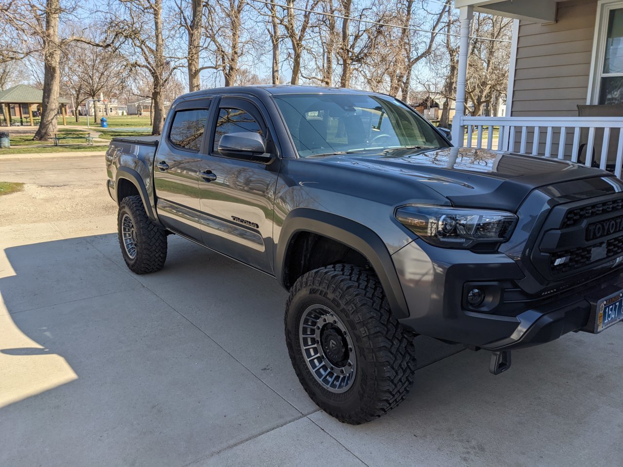

    Icon stage 3 and I left the overload in, so 2.75" front and 2" rear and sits perfectly level, you are going to have a hard time getting any suspension setups right now, everything is out of stock.
