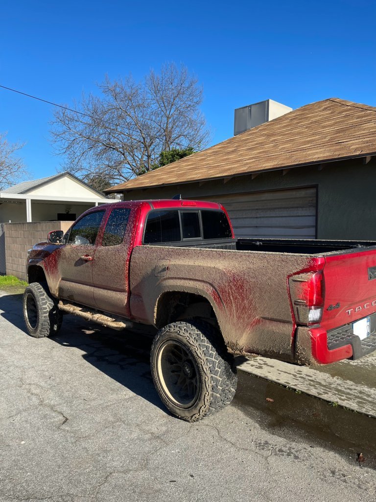

    Hello all! I need some advice on my 2020, 4 cylinder, 4x4 Tacoma. I purchased it with less than 17,000 miles on it at an amazing price with only one owner. It seemed like the steal of a life time. The owner before me had all the winds tinted, a sound system put in, side rails put on it but the only issue I saw was there was a lift kit and super over sized tires. Well, fast forward, I thought they were all simple fixes, but I found out the truck has a 6 inch lift, which means they cut the truck to make it all fit. The tires that are on the truck currently 33x22Rx12.5. I just need some recommendations on what would be the best lift kit to replace the 6 inch with since it has to always be a 6 inch kit because it was cut, what tires would be the best for the truck, or if its better to just sell it and stat over. I bought the truck in hope to be able to have a safe ride to camp, snowboard, and travel. I truly am not climbing rocks or going off road in the snow. Any advice is so gratefully appreciated.

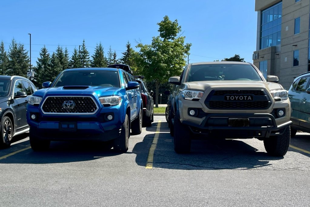

    Tuff call.
    I have a simple 2" Bilstein 5100 Lift with 33" pizza cutter tires. Rides great and is super reliable, especially in deep snow. (3 peak snow rated tires).
    It may not sound like a lot, but I would be able to cross a river or flooded streets, a little easier than a stock Taco.
    71tattooguy likes this.

    All I know is it is a Pro Comp 6 Inch Hybrid Lift Kit. I do not have any photos but I can get some photos.

    Removing a drop bracket lift involves having a piece of steel being welded into the frame cross member. Unless you are an experienced welder, you would need to take the truck to a fabrication shop that does that sort of stuff.
    If I were you, I would just leave it place and ignore all the nonsense about it riding poorly, not working well in the snow, etc. The main disadvantage of a drop bracket lift is the cut in the frame and you’ve already paid that price.

    One other thought... a 6" drop bracket lift is likely a combination of a 4" drop bracket lift and a 2" "IFS lift". If so, you could remove the 2" IFS lift and leave the 4" drop bracket in place. This would have the advantage of lowering your center of gravity.

    Yeah there's a lot of fear-mongering & misinformation that goes around regarding drop bracket lifts (the majority of which seems to come from people who have never had one). As was said, the crossmember is the only real downside of a DB lift, and you're already past that.
    You said it was a Pro-Comp lift, which is certainly not the worst of the bunch.
    You can lower it 2 inches (to 4" lift) no problem without changing anything but the shocks & springs (or if it has spacers, then by changing the height of the spacers).
    What shocks are on it now? (stock? adjustables of some sort?) Again, pictures will help us help you better.
    While you're at it, also get the vertical measurement from the center of the wheel hub to the edge of the fender above (measured on flat ground). This will tell exactly how much lift it has (stock measurement here would be 21" front, 22" rear).
    As for the tires being "too heavy for the axel" (axle), that probably was meant as the larger tire diameter steals away much of your power/acceleration (the axles themselves are fine). This was why I asked earlier if the axles were regeared. Regearing (say to 5.29:1) will help restore that lost power, as well as giving back some of your MPG. 5.29 should be good for 33" or 34" tires with your 4-cyl engine.
