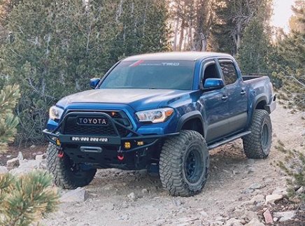

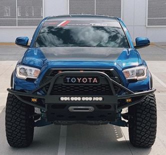

    Final question with regards to the suspension. Check out this rig, it appears to have a 1" to 2" protrusion of the tires outward from the body. I'm guessing this is either due to wider tires and or different UCAs? Spacers?
    How is this achived and are there any concerns I should have?
