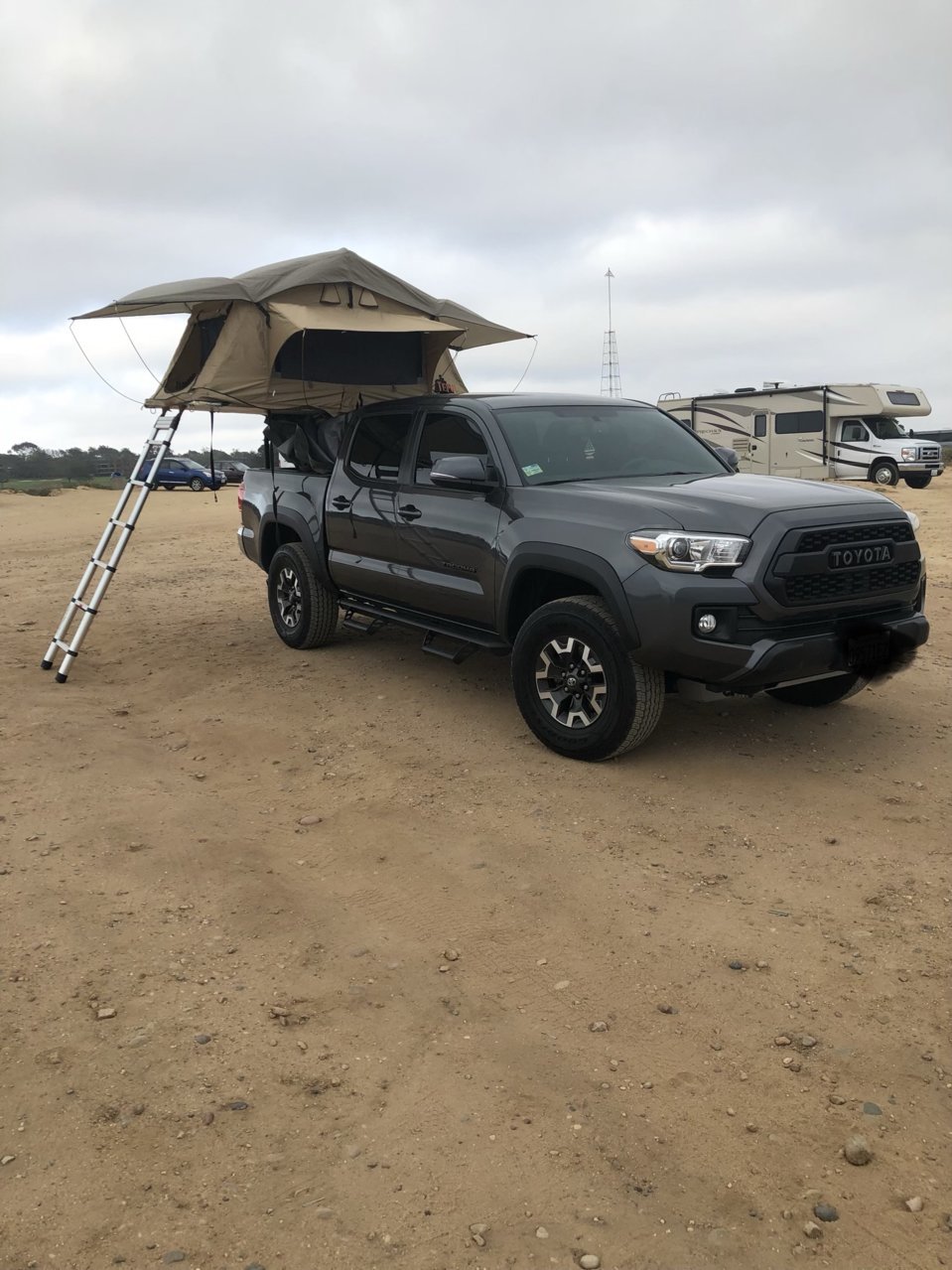

    FA227185-1115-4985-BF34-AF6D88C5F007.jpg So I’m a new Tacoma owner and trying to ease into the Off Road world as well. I’m looking for a lift/leveling kit and shock upgrade to do so. I don’t want to do anything crazy just go over washboard roads with no issues and travel through decent terrain to find nice camping spots. Mainly National Parks and such. I don’t want to go too high because this will be my daily driver and want to keep the gas mileage somewhat bearable. Open to any tips and suggestions! Pictures of your trucks with what you run would be helpful! Thank you guys in advance!

    OME coils and 5100 billies up front. Rides better than stock IMO. Seeing as you have that RTT, I'd say weight might become an issue with a fully loaded truck. Not sure on your budget, but I have no complaints about my Ironman leaf springs in the rear.

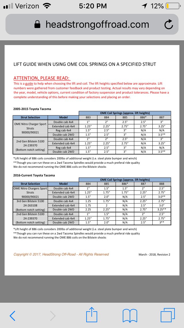

    What he said this is where I got started hs really helped me determine what I need to level my reg cab , I’ve yet to purchase the 5100’s with 883s so cant tell ya much about the ride quality but this is the route I’m gonna go once I get the cash put back

    As there have mentioned, 5100’s and an AAL for the rear. It’ll run ya under $700. Don’t get coils, use your stock ones. Set the front shock to the third setting (1.1” of lift) and the AAL in the rear should make you maintain close to factory ale (1” higher in rear). Aside, just invest in some good tires and you’ll be fine I’d thats all you’re doing. No need for lift.
