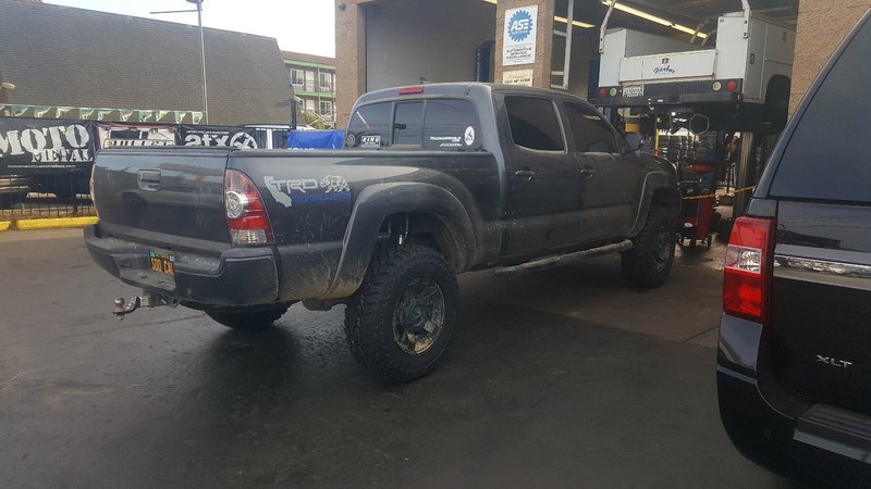

    roughly how much was this for ya? including installment if applicable

    This one was 3,800 installed but you can find cheaper ones that are just as good ... most people in here recommend marie from headstrong but i do believe they are moving atm n have put a hold on orders
