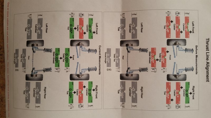

  15. Dec 22, 2016 at 9:37 PM

    yeah taking it to get aligned was one of the first things i did after installing it. Stock control arms and it was supposed to be a 3" but it ended up raising the front 4" haha. I've put around 4000-5000 miles on the truck since the lift kit install hoping the front would settle over time as the spring is broken in but its staying put lol

    Do you happen to have the alignment spec printout? I'm extremely curious how that turned out :popcorn:

    Here you go, sorry not sure how to rotate the picture lol

    Omg are you driving that piece of fuck on the highway?!? :bananadead:
    That's gotta be the sketchiest alignment sheet I've ever seen lol.
    I'm saving that gem for the "my alignment is perfect with stock UCA's" crowd :rofl:
